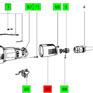

The handle could be modified to go over the back screw (part#88). But since this is a plastic screw, the handle must be somewhat permanently attached to the Domino. The DF500 will not fit in the systainer anymore.
Another solution I considered was to modify/recreate the rear cap (part#90) to add insert(s) to screw the handle in. That will fix the problem. Having said that with the handle upright, the center of mass is very far from the back hand; I now need both hands to lift the domino, so the risk of dropping it is more limited.

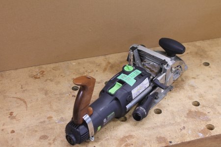

Here's the handle for my DF500 (installed only when I have lots of mortises to mill horizontally). I carry the machine with both hands, not just with the handle as the plane handle could break off at the bottom.

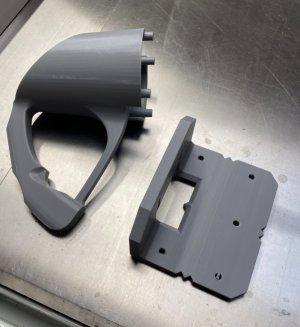

Just upload one on printable. Designing an ergonomic handle has been more time-consuming than expected:
The handle is not retained by the back screw (it is not designed to be screw/unscrew many times). After testing existing designs, a 2 part solution, one replacing the back cover of the domino with a 3d-printed part with threaded insert is an overkill. The handle gives more control when plunging.
I'm getting these two 3D accessories tomorrow (handle and improved support bracket). My friend's bro charged me $40 Cdn for them ($20 each).

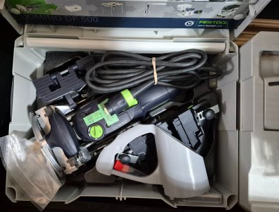

Finally, I tried out the 3D printed accessories. They worked as designed. The handle fits inside the systainer perfectly.

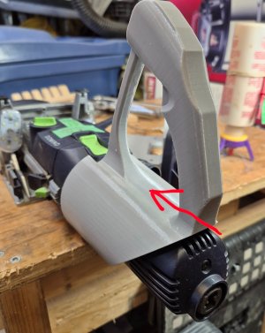

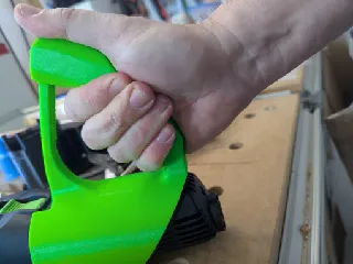

For the handle, the main force of push should be at or close to the bottom of the handle. I know this because of the experience of using the DF700. The lower the better unless you enjoy arm fatigue.😆
Anyone my physical size (small) who has ever made a few dozen of mortises with the DF700 would know what I'm talking about. I've never borrowed a DF700 since.
Thanks for drawing the red line on the photo to emphasize the pushing location and direction of the force.
Why is the handle so tall? Is there utility to such a tall handle?
That's exactly what I was wondering, it seems way taller than necessary or practical, given the bulk of the pushing force is usually fairly close to the Domino body to maintain control?
On my DF700 I always grip at the lower rear of the handle for this reason.
The last picture may make it bigger than it really is. It is designed to fit your hand. See on printables:
I am not a physicist, but think the long handle and holding position make it easier to control. With all the force produced by the multi-axis rotation, the long lever should make it easier to handle than a shorter one would.
It does on the DF700, the trouble here was due to the angle of the shot the handle looked abnormally huge!
I tried it...compared to holding the end of the barrel near the cord, wrapping around the handle and pushing it felt harder as the force was angled towards the body.
Test runs might not count, and I'll use it more intensively in a project before making a final conclusion.
