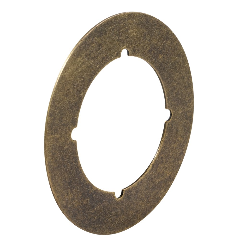

V Van G Member Joined May 7, 2012 Messages 42 Nov 10, 2013 #1 Handleset bore was drilled out 1/4" shy and the handle plate doesn't cover the hole properly. Any suggestions on filling the left 1/4" of the radius so the cover plate finishes properly? Attachments IMG_0473.jpg 79.6 KB · Views: 379 IMG_0472.jpg 83.3 KB · Views: 350
barnowl Member Joined Feb 14, 2008 Messages 247 Nov 10, 2013 #2 Prime-Line Products U 9498 Backplate, 3-1/2-Inch, Antique Brass $6 the pair, at Amazon
V Van G Member Joined May 7, 2012 Messages 42 Nov 10, 2013 #3 Top shelf. Thank you. Just need to see if I can get it in black finish.
tjbnwi Member Joined May 12, 2008 Messages 7,383 Nov 10, 2013 #4 Put them on all the doors in that area so it looks planned. Tom
ajones Member Joined Mar 27, 2010 Messages 2,062 Nov 10, 2013 #5 Van G said: Top shelf. Thank you. Just need to see if I can get it in black finish. Click to expand... Buy a black aerosol job done
Locky Festool Dealer Member Joined May 3, 2013 Messages 138 Nov 10, 2013 #7 or you could just buy a new latch/strike mech in the proper set back those mech should be universal
