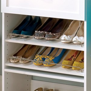

I would note though, that my shoe shelves are on an angle, lower in front than in the rear. A 3/4” x 3/4” strip runs horrizontally to catch the heels and prevent the shoes from falling out.
This example also angles the shelves, but uses a wire form to keep the shoes from migrating off the shelf. A piece of clear acrylic would also work.
