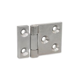

You could also just get some hole-less butt hinges and drill where you want the holes?
4nthony said:
That's actually not a bad idea. I could even try and cut down the leaf on a larger hinge to fit the smaller door.

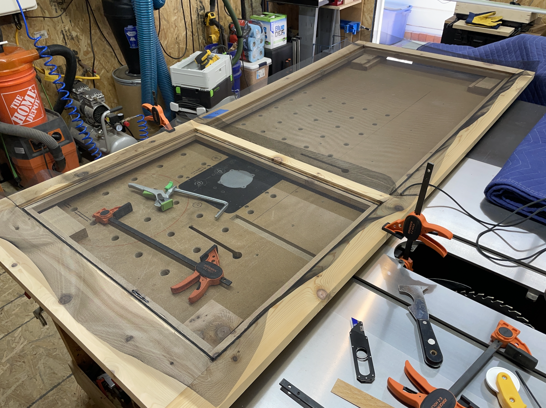

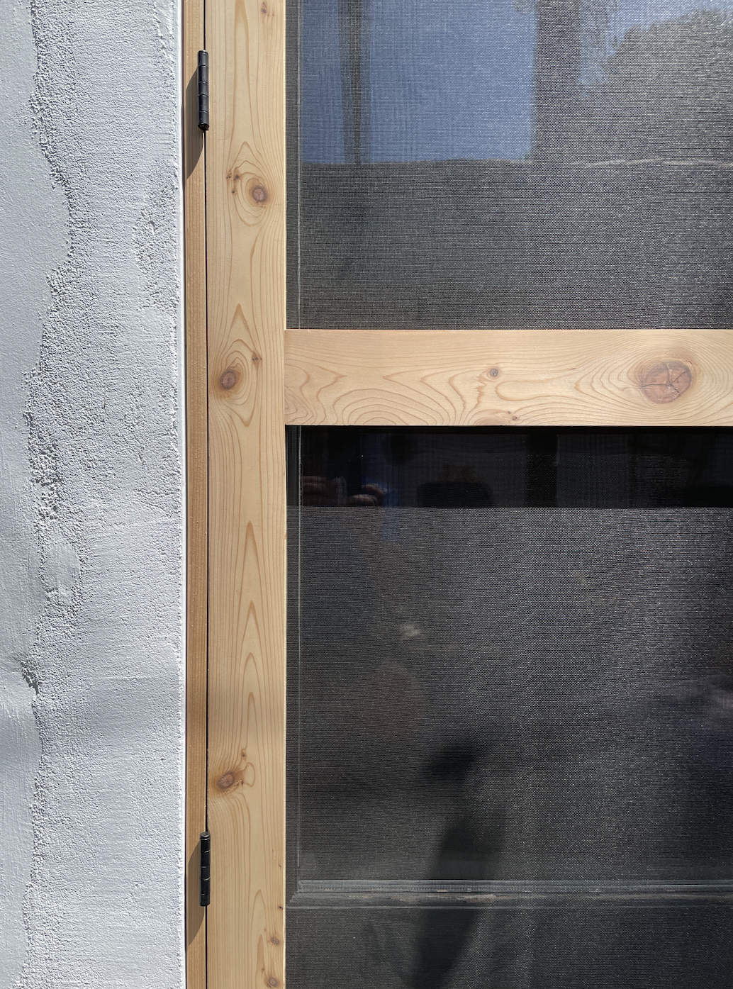

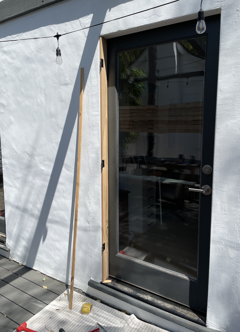

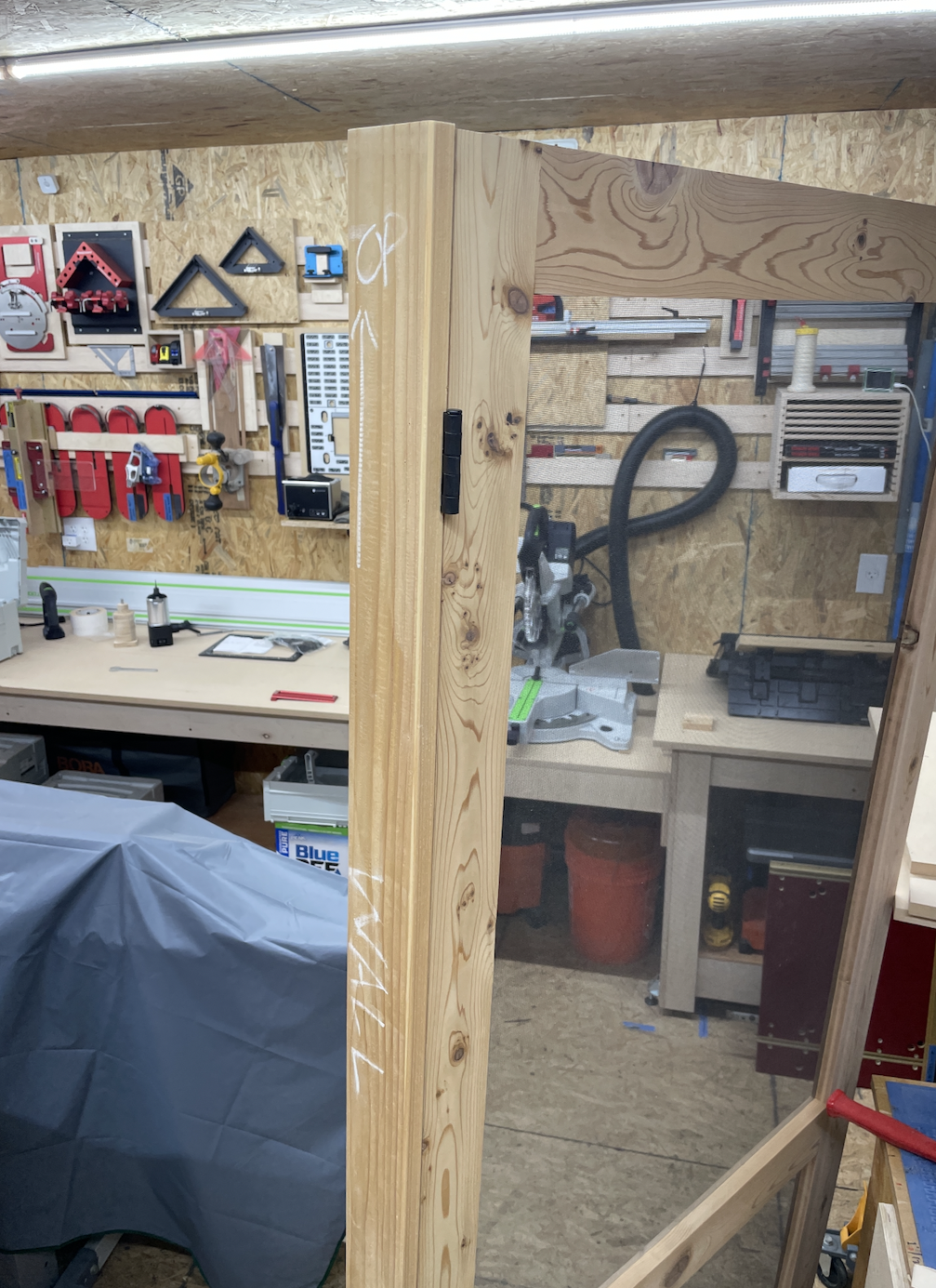

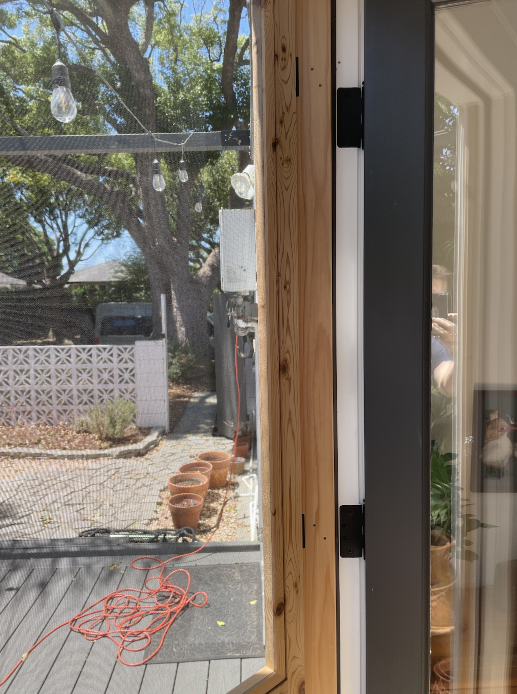

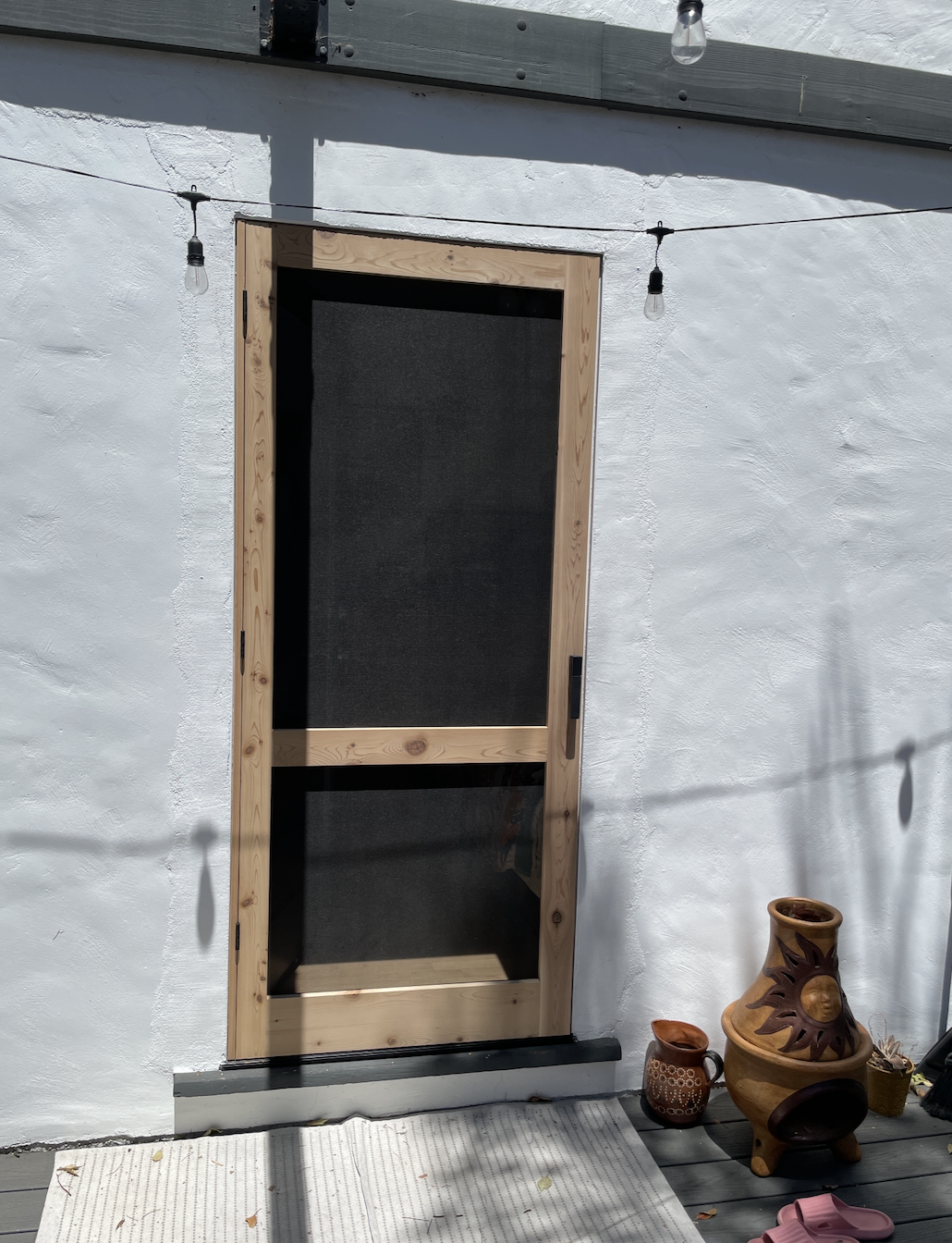

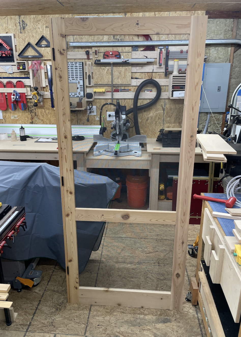

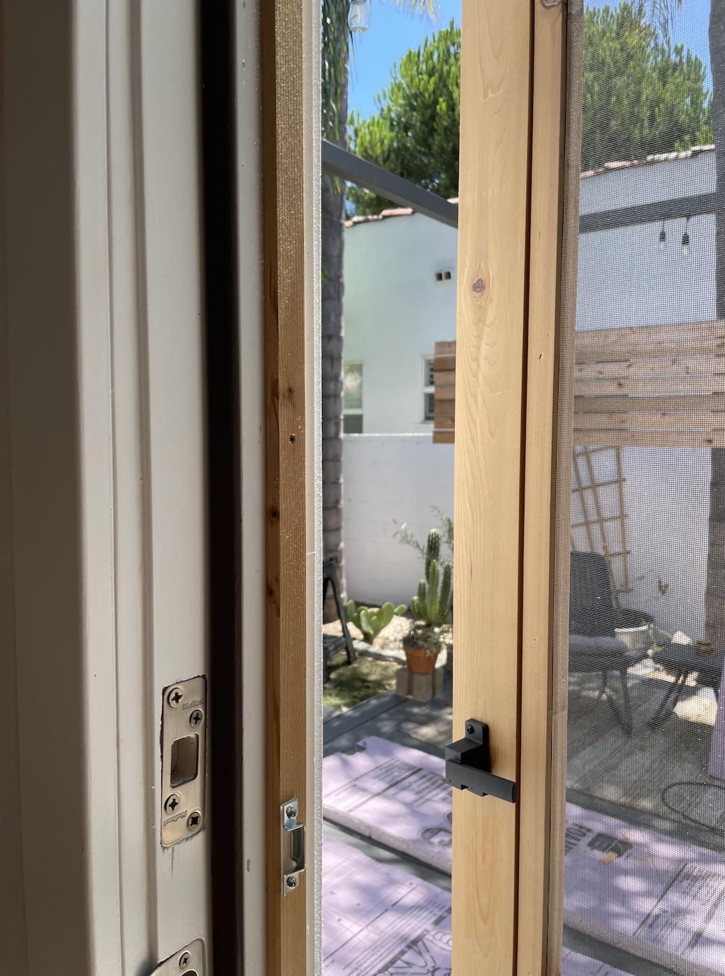

As much as I hate to do it, I think I'm just going to grab some smaller butt hinges, install a partial jamb on the hinge side (I've already got the piece milled up and waiting), trim the door to accommodate the extra width of the jamb, and mount it.
I think we're going to need to see some photos of the results posted after all that.
