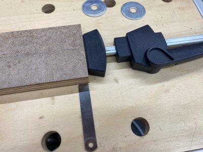

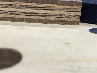

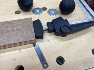

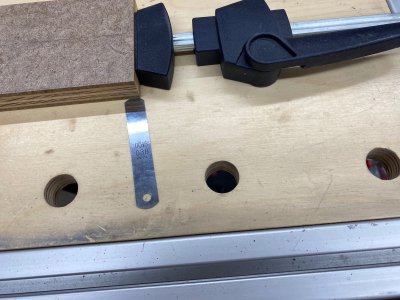

Like this? And this is the best case scenario because I'm using a scrap of MDO which will be flatter and smoother than probably any other wood product you clamp up.
1. MDO being clamped with the clamp only = .025" lift.
2. MDO with clamp and knob attached = .015" lift.
3. MDO with clamp, knob and fender washer attached = .0015" lift.
4. A close-up of photo #3 to see the overall flatness of the MDO.
