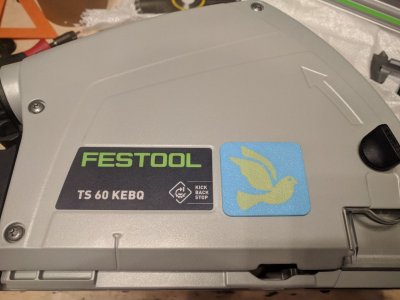

Had Mafell Mt 55 as my first saw a couple of years ago. Had sold it.
Just bought a Festool TS 60. (Before using) I like Festool saw more and I like its rails more. While both manufacturers have their pros.

Hi FOG,
Thanks for this wealth of information on Festool, other tools and solutions.
Now that the TS 60 has been out for a while, I’m curious about its strengths or drawbacks compared to the Mafell MT55cc.
Obviously these are both top-tier saws.
1.
In previous threads, users have been impressed with the extra power and build quality of the Mafell compared to the TS55. For example,
https://www.festoolownersgroup.com/other-tools-accessories/mafell-mt55-cc/
In North America, the latest 120V Mafell is 13.5A compared to TS55 at 10A. However, the TS60 is 13A and brushless.
TS55, assuming 80% efficiency for brushed motor = 120*10*80% = 960 watts output.
Mafell, assuming 80% efficiency for brushed motor = 120*13.5*80% = 1300 watts output.
TS60, assuming 90% efficiency for brushless motor = 120*13*90% = 1400 watts output.
2.
Mafell/Bosch rails join easily, but don’t have anti-friction glide strips. The latest TSO and Festool track connectors make joining Festool rails more straightforward.
Mafell/Bosch rails are narrower and have a clamping position closer to the cutting edge, which is helpful for narrower stock. Bench dogs can’t be too high on the Mafell rail or they will interfere with the progress of the saw. Mafell/Bosch rails hove no T-track on top, which is a limitation for jigs and third-party accessories.
Mafell/Bosch splinter guards have a bulb that is retained within the profile of the extruded rail, eliminating the issue of Festool splinterguards which can peel away from the aluminum (especially in cold weather, etc.).
https://www.festoolownersgroup.com/festool-tools-accessories/splinter-guard-peeling-off-at-the-end/
3.
Festool saws allow lateral trunnion adjustment to match other saws or existing rails; Mafell MT55 only has lateral adjustment at the rear trunnion. If you have multiple saws (mix of red and green) they must all be matched to the Mafell. If you have two Mafell saws, can you match them?
https://www.festoolownersgroup.com/other-tools-accessories/mafell-mt55-bevel-cut-dissapointing/
4.
As per [member=15585]Svar[/member] ’s OP in the link above, the Mafell trunnions are made of steel and are more rigid than on the TS55. However, the trunnions on the TS60 are also made of steel. (See Reply 28 and 29 of the thread below.)
https://www.festoolownersgroup.com/...crushes-corded-competitors-in-test-incl-ts75/
5.
There are issues with the Mafell blade not cutting on the splinter guard when bevelled. Not sure if Mafell has improved that in recent years. There is a fix for this issue per Bisch Basch Bosch.
6.
Festool TS60 works with FSK rails, in addition to the long FS guide rails.
7.
Motor of the TS60 does not overhang the rail.
8.
Greater depth of cut for the TS60 than the MT55. Blade availability may be somewhat more limited.
I’ve used various versions of the TS55, in addition to the TS75, extensively. I have had hands on the TS60 and MT55, but no significant work usage.
Seems like Festool has put a lot of thought and craft into the TS60. And the Mafell is a beautiful, solid tool.
If you were starting fresh—no sunk cost bias of existing rails, etc.—what would you choose at this point?
Which saw did you end up buying and how do you like it? Also what swayed you eventually?

The Mafell 55cc has been out for 11 years so to compare it to the Ts60 says a lot of the older saw
Personally and just my opinion I think that the Festool has stolen the crown in this dual
And as much as I like the Ts60, I'm drawn to the benefits of the cordless Tsc 55 Keb, 🥴🤔
I might call into the Saw Centre in Edinburgh
to have a further look and feel of the two Festool models
