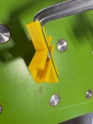

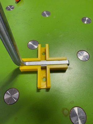

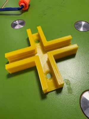

So I'm doing this research for a saw horse project with t-track in it, and have found that the stuff sold by McMaster-Carr is perfect for both the ratchet and screw clamps.
Note that I haven't actually purchased it yet, but I did download the CAD model and use that to create a 3D print of an intersecting part, and they fit fine in there.
Will report back after I've purchased the real stuff.
