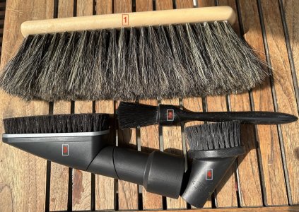

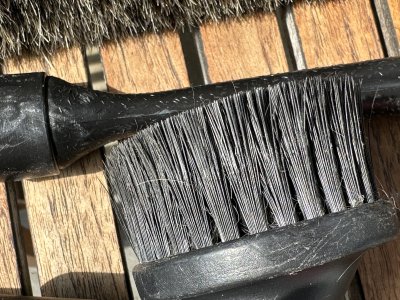

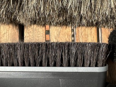

I picked up the cleaning set mainly for the garage and car. The crevice tool and upholstery brush get the most use, but I wish the hose-end brush swiveled—feels a bit stiff.
FWIW...If you're doing a lot of car detailing Miele offers a brush that swivels. The bonus round is that it also has soft boar bristles rather than the hard plastic bristles that Festool uses. Here's a quick comparison:
1. Boar bristle car wash brush
2. Boar bristle detail brush
3. Miele boar bristle vac brush that swivels
4. Festool vac brush with plastic bristles
And here are close-up photos of the bristles on the Miele vs the Festool. Plastic bristles can scratch soft surfaces and because they aren't flagged on the end, they also don't clean as well. I'd never use a plastic bristled brush on something with a "piano style" finish.
