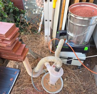

I know I'm resurrecting an older thread, but I've gotta say, Dust Deputies rock!
My son brought home a ute load of about 40L/M or so of really nice quality Jarrah flooring that'd been pulled up out of a job, so I hooked up the Midi to the thicknesser and took them all from 19mm to 14mm thick as I'll use them for whisky presentation boxes.
I filled 3 x 20L drums with the shavings, and when if was full each time the Midi sucked some shavings in. The second pic is when I emptied the long life bag which filled the drum about 1/3rd high.
The Midi easily kept up with the aggressive planing, and the DD is just such a massive time and effort saver! Having a long life bag is really worth the investment too!

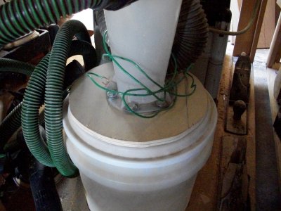

I second...I have two DDs (one for the Kapex and one for the drill press/sanding station). I don't even bother to check how full the shop vacs are.

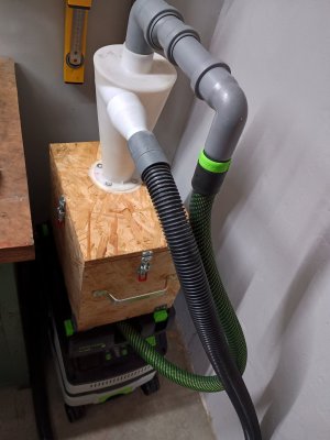

I use a cheap cyclone on a selfmade wooden box for my CTL Mini and am quite happy with the results. There is not much coming through the cyclone into the vacuum bag. The systainer latches are 3D printed and the cyclone has an OsVac adapter. Since I have a multitude of different brand machines, the hose connection often times doesn't fit so I print my own with the OsVac connector.

I've had a CT36 hooked up to a DD sitting on a ~60L tank connected to my CNC the last 15+ years, I think I've emptied the CT maybe 3 times so far!
They're a game changer for sure and more than worth every cent.

That sounds about right because I had little to almost nothing to dump from my Kapex shop vac during the last check (which has been heavily used). I haven't checked the vac's drum since pandemic!
That sounds about right because I had little to almost nothing to dump from my Kapex shop vac during the last check (which has been heavily used). I haven't checked the drum since pandemic!
With light use I empty the drum, which is a cut down large gas tank, probably once a fortnight or so. If I'm doing a lot of machining it's emptied every couple days. So long as the tank doesn't overfill almost nothing ends up in the CT.
