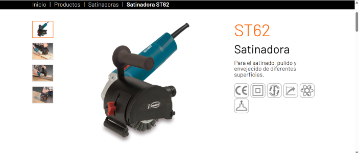

Rustofix was essentially an "accessory" of sorts mounted to the RAS 180 sander body. It had way lower speeds compared to a normal angle grinder. A speed-controlled one at 3000-ish rpm would probably work, but you really want less than that and the torque the gearing provides.
There are other makers for this type of stuff though. Not much sense fudging it with an angle grinder unless for a one-off job. Finding a powerful-enough angle grinder with speed control is a challenge on its own.
