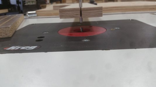

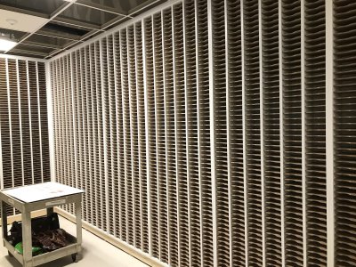

9) Jigs (somewhat) We use dedicated machines for dovetails and drilling/inserting concealed hinges.
6)That one is pretty obscure to begin with, especially as a dedicated machine. I do however have a substitute "jig" that works on my regular router table. It accomplishes the same thing. I use it occasionally, to cut the dado in the opposite side of partitions. They are cut on a CNC originally, but turning them over to do a "second operation", is a waste of time.
The CNC can cut multiple parts, from a single sheet, but flipping them over, means one at a time.
The pin-router is one at a time too, but it is not tying up the CNC. It can continue and both can work at the same time.
