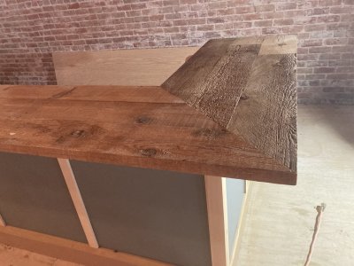

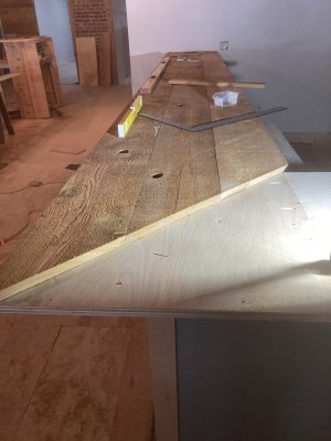

I have suspended beams from ceilings with GRK screws.we randomly spaced the holes.Some hole were plugged the convention way and some were filled with “knots”here is one example in the photos below
