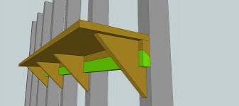

We all hang our work once in a while.Sometimes a stealth mount is tantamount.
I'm showing this project more for hanging ideas than anything else.
I try to sell customers 3-D signs whenever I can. Reasons s/b obvious.
They stand out, I'm good at it, it keeps me in my woodshop rather than the fab shop.
Very few sign shops are set up for the sign shown, and any customer with good taste at all will choose one like shown over a flat ugly sign with screws showing.
(off my pedestal)
What is different on my cleats is a couple extra steps to keep it on the wall.
Signs are outside. Or near hands. You have to fasten down good mainly for wind. I can't have my phone ringing.
If you are hanging on a child's wall....enough said?
Basically I incorporate a hidden set screw as extra provision and silicone calk.
Also an interference fit as possible. A couple of mine snap on the wall. Many ways to pull it off.
