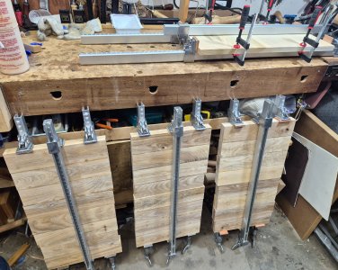

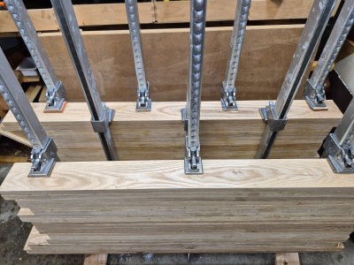

With such consensus on Method A (which happens to be my usual clamping approach), I went ahead with it and did the glue-ups (first photo).

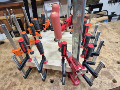

Previously, as shown in the second photo, I did try the Method B on some shorter pieces that also needed to be glued up (the ones on the bench top were to be glued with Method B; those on the floor were done with Method A). I was wondering if other woodworkers would prefer Method B and so I asked.

Ah, you are using low-overhang edge clamps which cannot reach the middle of the boards. Now makes sense why you considered seriously the "option B".
Not sure what other clamps you got around, or how many, but the issue I see is the uneven clamping you got there with only one side of the boards clamped. Most my clamps are a variation of C-clamps, not having this limitation .. and instead allowing far less a force to be applied.
But it is easy to say, one needs to work with /the clamps/ one has..
@mino - I have half a dozen of 12" deep-throat clamps, bought from a welder, as well as two 8" deep-throat clamps, but the two wider boards shown in method B were pretty flat across and flush in the middle, and that was why I did not use any clamps in the middle. The rest on which I used method A were narrower boards.
"I see is the uneven clamping you got there with only one side of the boards clamped."
That glue-up started with even clamping, but after an hour, I removed some clamps from there to continue working on the rest. I actually have lots and lots of clamps, including the longer Dubuque ones, but my bench works best with the shorter ones.

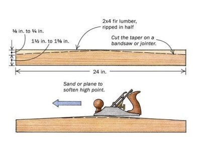

Clamping cawls may be helpful
I have some sets of clamping cauls of two different lengths (packing tape in the middle), but have seldom used them now since I bought the DF500, which, if used, aligns the surfaces and edges well.

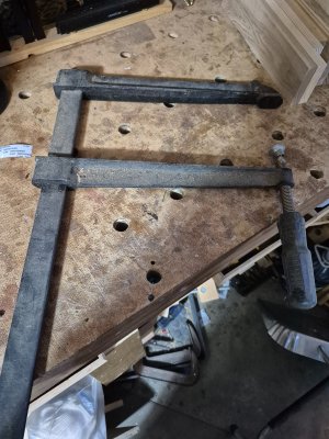

I did use two 8" deep throat clamps to apply pressure to the centre when clamping two boards to thickness (under Method B). The other pic shows one of the 12" deep throat clamps

Cauls will help when the tension in the freshly cut lumber is let out and sometimes causes the wood to warp during glue-up and before the wood moisture reaches equilibrium. Dominos alone won't do that.

But I'd definitely alternate the clamps on the top and bottom to ensure evenness because when you move that heavy glue-up and place it vertically on the floor (to prevent the weight of the glue-up from causing the panel to bow or warp as the glue cures), you run the risk of upsetting the panel.
