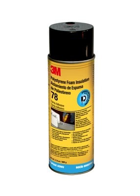

I've used the 3M Super 78 multipurpose Adhesive spray.  Also works great to bond foam together....

Baremeg55 said:
I've used the 3M Super 77 multipurpose Adhesive spray.  Also works great to bond foam together....
Gary
They actually make a Super 78 which is specific for polystyrene. Super 77 degrades it.
mediawebserver
http://solutions.3m.com/wps/portal/3M/en_US/Adhesives/Tapes/Products/~/3M-Polystyrene-Foam-Insulation-78-Inverted-Spray-Adhesive?N=5396314+3294246655&rt=rud
sae said:
Gary
Thanks for the link.  I've kept a can of the Super 77 around for years.  Comes in real handy at times when nothing else will work, but the only drawback is it's real messy and hard to clean up.  I'll have to look at getting some of the Super 78 now for plastics.
