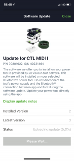

Hi ,i have bought Ctl Midi a two days ago, today I have connected the Ctl Midi and iPhone X with bluetooth connection via Festool App and I have done the software update I have made a screenshoot(attachment). Note that the Ctl midi was fully functional before update.
The update went all good, but then the Ctl showed no signs of life, I have tried virtually everything. Are there reset possibility or something else or do I need to send the Ctl back to Festool?

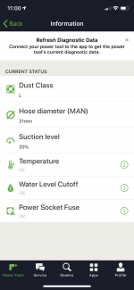

Everything was fine until the update, it's a EU version. As i said there is not a single sign of life, no green light, no bluetooth blue light, there is nothing i can do. Here is the last known state of Ctl, as you see in attachment everything was ok.

Strange. Maybe the pulled the update? Since I see no new update, and never updated it myself.

I have pressed the on/off button 100x times until now and nothing happens. Update or any kind of reset is impossible to make because Festool app sees the Ctl not, it's listed as "out of range".
