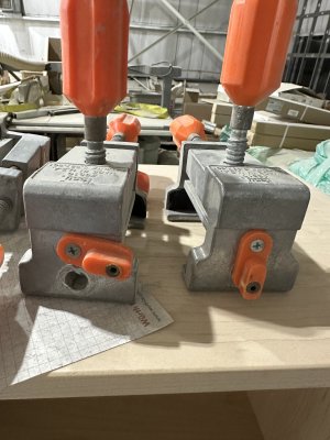

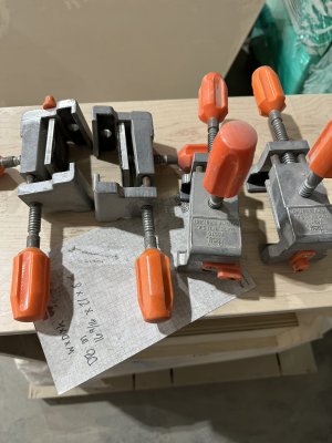

They were not available when I last installed cabinets, but I would definitely get a pair if I were to do so today. Face frame clamps are available from Bessey, Kreg and others. I have not tested these but they look very helpful.
The face frame clamps work really well. They allow you to bring the cabinets together and shift them front to rear.
One suggestion I have is after you drill the pilot hole, flip up the drill guide, redrill the o face frame with a screw clearence hole. This prevents the screw from acting like a jack. Just be careful not to drill too deep.
These are Pony l brand, I believe they were first to market 20 or so years ago.
