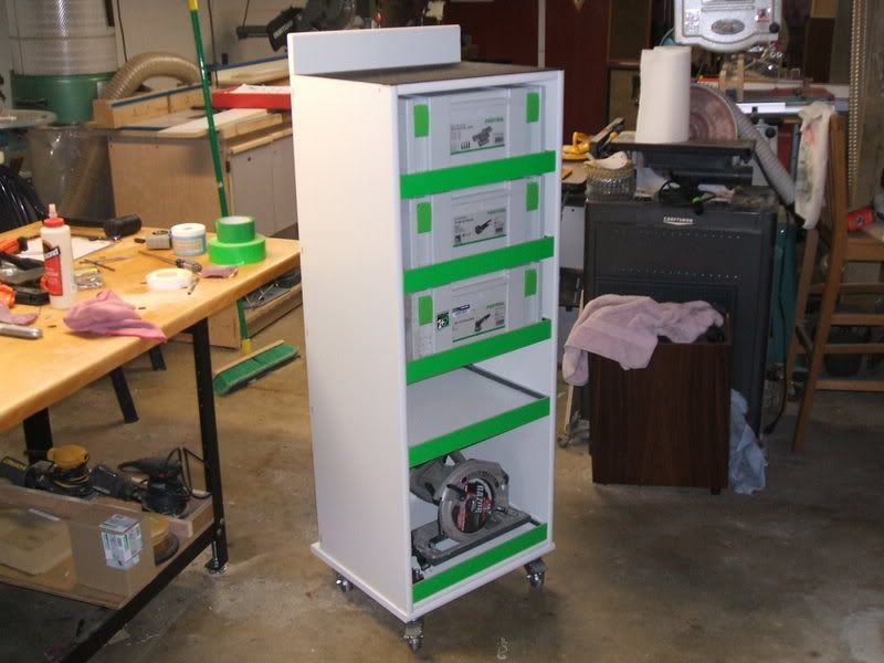

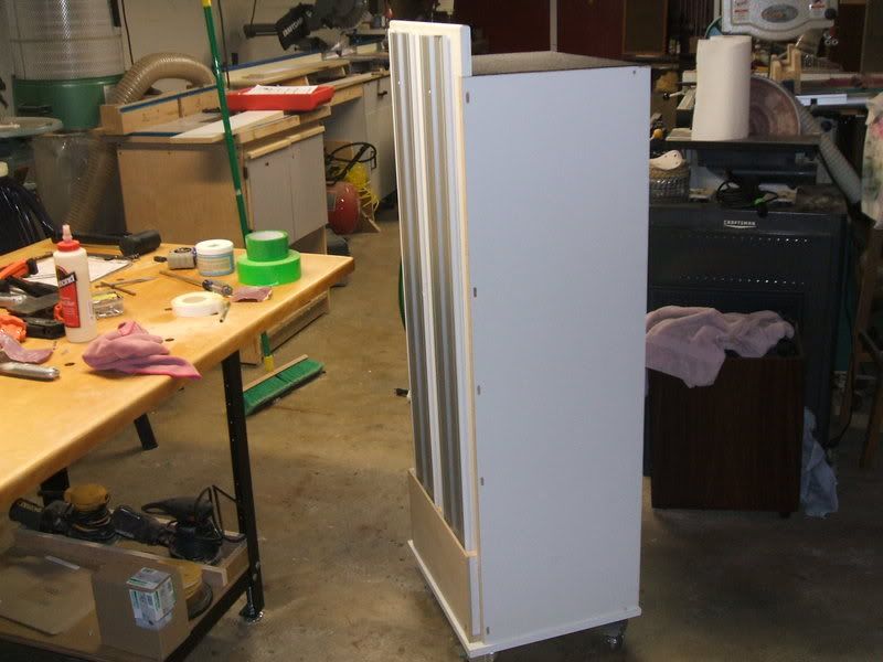

Thought I'd show mine off. After looking at how nice all the others where I had to make one myself.
Used Domino's and a few Miller Dowels. 14" full extension slides and a couple of 4' shelves latter this is what I came up with.
Thanks for all the great ideas in this thread.
Gary
Gary,
That looks great!  It is right in line with all the other great models we've seen in this discussion.
But what's the funny gray-colored tool I see in the bottom shelf?
Matthew

I don't see anything gray in my pictures:) I thought I may catch flack for the saw rails on the back, not the saw.
This setup was purchased long before I even knew anything about Festool, and I must admit it works just fine. Dust collection stinks, but cuts well.
I do have one open slot waiting for my next Festool purchase though.
Gary
No flack about the rail holder.  But that broom!  And the tape!  You're hooked.
