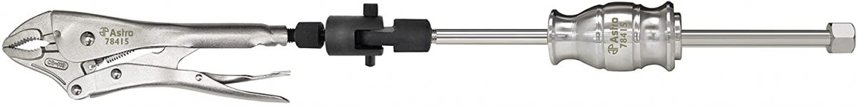

Maybe he needs to go to the auto parts store and find the cheapest gear puller he can find.
I like the slide hammer attached to vise grips shown above.
