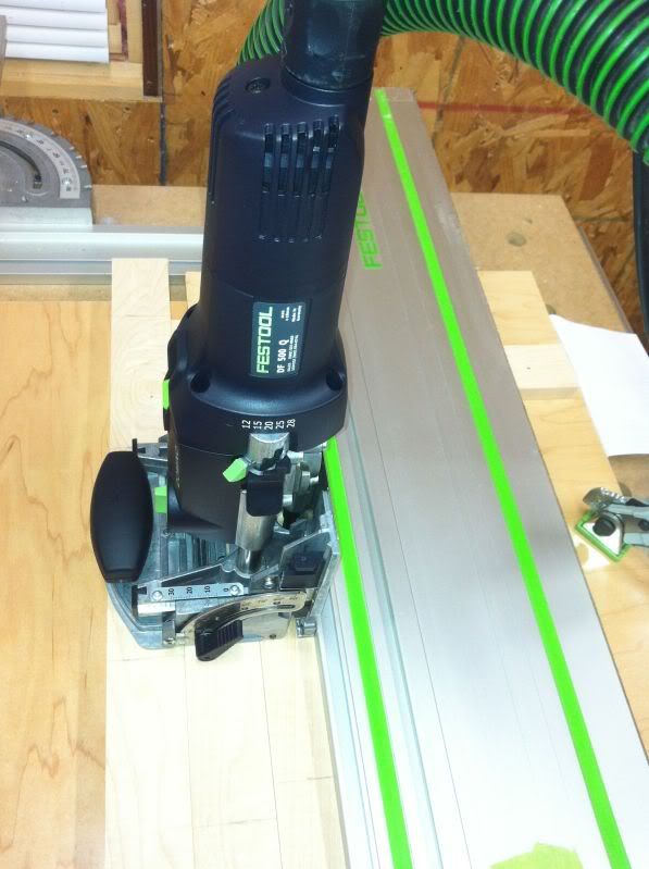

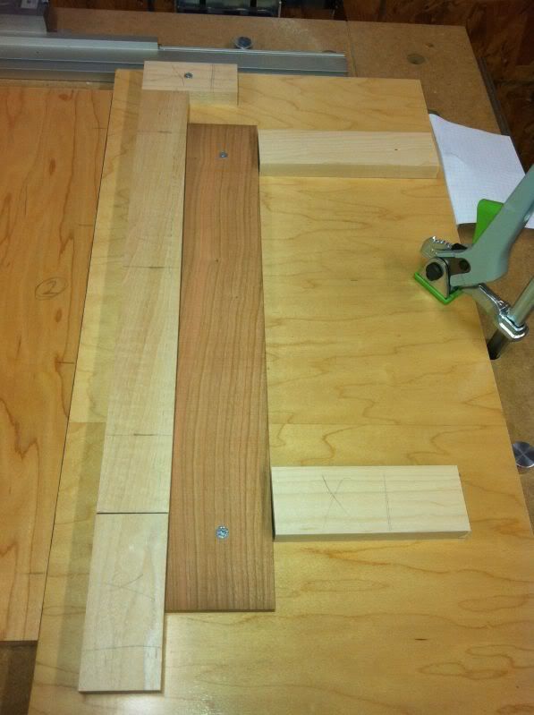

I had a few people asking me how I did it, and if I had any photos. so here goes...
Remember, it was Tom's idea not mine!
The first photo shows the jig clamped to MFT, the far left piece of wood is the apron I am cutting the dominoes into.
The second photo shows the rail in place on top of the apron.
And of course, the final photo shows the cutting.
Hope this helps, anyone.
John
