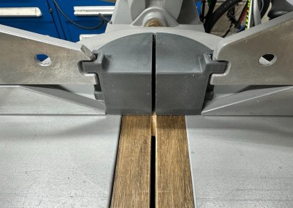

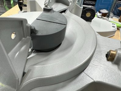

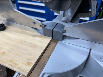

Today, I had the first chance to try the Zci block (as well as the silencer blade). The cut was clean and there wasn't any chip-out at the back, so the block worked very well as designed. If you're looking for a 90* cut zci block for your Kapex, this is a great option.
However, as expected, the dust collection did suffer a bit as compared to not using the block, as shown in the photos.
So, I will use the block when I need perfect cuts; for ordinary stock preparation, I'll make cuts without it.
