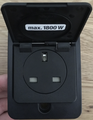

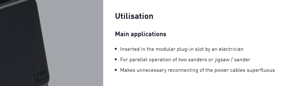

Of note is that Festool actually sell a power module to add an extra auto-start power socket for the CT26/36/48's, and explicitly describe it as giving you the ability to run two tools off the CT simultaneously!
This alone infers to me that within reason, the specified socket rating isn't as critical as thought.
Those outlets were EU-only and had a specified power limit of 1800W.
EU Secondary Power Outlet Installation
I noted that, but also that they did had the UK version, but not for the US which was suspected because of UL/Legislation issues.
But if a socket was overloaded, the MOV in the control circuitry should kick in and cut power, but as you say earlier, depending on how the load was drawn, you could still end up with some burnt cabling.
The tools they list are sander and jigsaw though. (edit: at least the NA ones I was looking at before you even posted it). From the Modul-SD E/A version (the one with automatic switching). The Modul-SD (manual switching) has a more generic 'tool'. Clue?

If you look at what those sockets were, they were to add a second power outlet to a CT, and were available in two forms, one that was a straight power pass through, and one that was switched with the vac power.
They did not offer them in a form that would turn the vac off and on when it detected a power draw like the current outlets do, so that strongly hints the current limitation is in the smart circuitry, but it may also be in the wiring of the "primary" power socket.

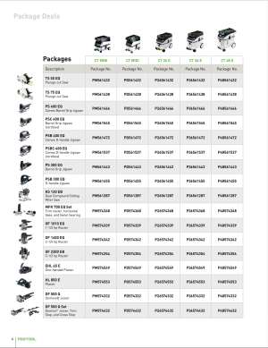

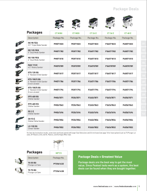

Here's an example of what Chuck was referring to in his earlier post. These are 2 pages from a Festool catalog touting their Package Deals. "Package deals are the best way to get the most value. Since Festool tools work as a system, the best deals can be found when they are bought together."
What struck me with these catalog pages, is that instead of telling you to purchase vacuum part number X and tool part number Y, they give you a single part number that bundles the vacuum & the tool together. That's a pretty strong indication of compatibility.
Their marketing photos for the Kapex also show it plugged into a CT.
Festool’s position is quite obviously that the Kapex and other tools are intended to be plugged into the dust extractor.
