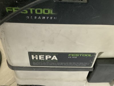

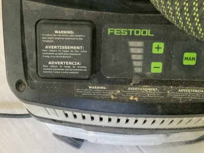

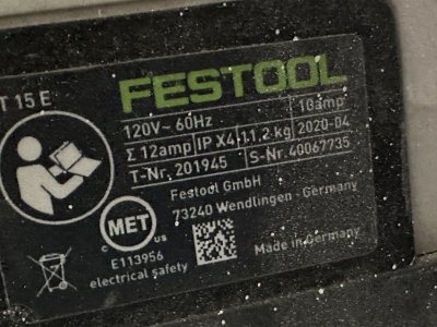

I posted a picture (5ish up) of the receptacle cover on my CT 15E, it states the max connected amperage is 2 amps. The units ID plate shows the CT at 10 amps.
The two added is 12 amps, the shown Sigma number is 12 amps. This indicates that the 2 amps applied to the receptacle is nothing more than a formula applied number to meet the NEC 80% rule. 80% of 15 amps is 12 amps. This allows Festool to meet the NEC requirements so they can get the “listing” they need to sell in the U.S. In Festool’s case they’re using MET testing to U.S. standards as indicated on the label. MET is a NRTL recognized by OSHA.
The 2 amps shown on the cover (any of the CT covers) has nothing to do with the real world load capacity of the receptacle. It is nothing more than the results of a math function.

If it is not a math function, why the Sigma showing 12A on the CT ID plate? The definition of the Sigma is a math function.
As an engineer would you put in a symbol and number that mean nothing?

The basis in reality is the 12 amps is shown as Σ 12amps. Sigma is defined as a math function, the sum of to be exact.

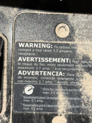

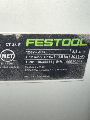

Below (CT 36) they rated the receptacle at 3.7 amps, the units amp rating is 8.3, the Σ is shown as 12 amps, 3.7 plus 8.3 =12. The label for the receptacle rating has been moved from the cover to the CT body next to the cover. It also appears Festool is showing and having the unit tested at the low end of the suction setting, on the label it shows 9.1 amps at max suction.
The engineers must be hard at work to produce both a 2 amp load system and a 3.7 amps load system.

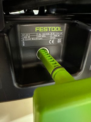

Hey Tom, I'll save you the effort to look in December... :)

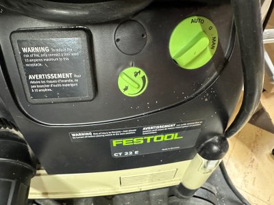

This is what my CT 22 says.
Your label, with the sigma 12A has a max continuous motor load of 8.3A. Hence the remaining that the receptacle is rated for 'continuous load' according to NEC is 3.7A. There are other models out there throughout the years apparently that have 9A and 10A, hence why we can get down to 2A. Yes, it's a math function, but the NEC 80% rule applies to the END rating, not that receptacle.

As Cheese’s pictures show, the CT 22 has a rating of 1200W (10 amps) the Σ is 2400 watt’s (20 amps) 10 for the unit 10 for the receptacle. They did not apply the 80% rule (16 amps) to the CT 22 pictured. The CT 22 came with a 5-20P and a 12 gauge cord (also a dongle for with a 5-20R and a 5-15P). The CT 22 does not have a U.S. listing agency shown, it does carry a CE listing for the EU, this is a manufacture applied rating. My guess is they went to MET because the U.S. stopped recognizing the CE listing. Once they moved to MET Festool probably had to apply the 80% rule.

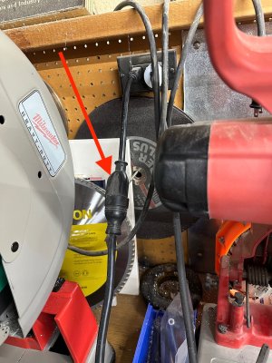

For those unfamiliar with the CT 22 electrical cord, here's the dongle Tom's referring to. The CT 22 came with a 12 gauge cord that was terminated with a 5-20Plug. The dongle was also 12 gauge wire with a 5-20Receptacle on one end and a standard 5-15Plug on the other.
