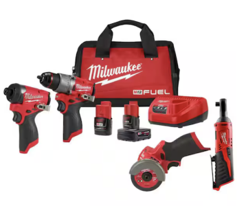

Perhaps I'm too used to Milwaukee Tool deals like "Buy this impact driver and hammer drill/driver and get a free tire inflator or grease gun."
To me they're just multiple SKUs offered in a discounted package, and even if you can connect your KAPEX to your CT, it doesn't mean plugging the KAPEX into the CT, at least not to me.

At least in the US, one SKU will often get you a drill/driver, impact driver and some other tool like a ratchet or die grinder, so being sold together means nothing here other than a way to package tools together. 🤷‍♂️

Unless I'm mistaken aren't all of those Milwaukee's using the same battery, in other words like as in a system or fully compatible package, even though unlike the Festool promo it doesn't explicitly state that?
