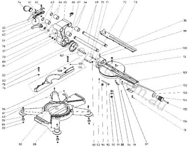

Unless I'm mistaken the drawing seems to indicate it's slid in place from the rear of the table, which is a horrible design if so.
I notice also the flared sides at the rear of the insert.

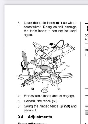

Hi guys, thanks for your input, according to the manual that comes with the saw the insert is levered out with a screwdriver… never seen such a bad design in all my days.

Levered out, wow? That's insane as the drawing looks like it has 6 tabs along the bottom of each side?
Always me wonder how designs like this get the go ahead. Reminds me of the faulty heater in my old ute, to get to the heater and pipes you had to remove the engine! 30 seconds to fix a stuck valve, $1500 labour to pull the engine out and put it back again!
Yep, that looks like it'll break the tabs in the drawing I attached, great design!
I'd try taking the fence (part 60) off and seeing if you can remove it from the rear intact?
It's hard to believe in this day & age that this type of design would ever make it to production. 😵‍💫 😵‍💫 😵‍💫

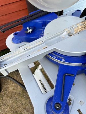

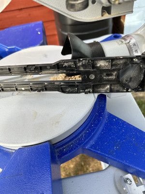

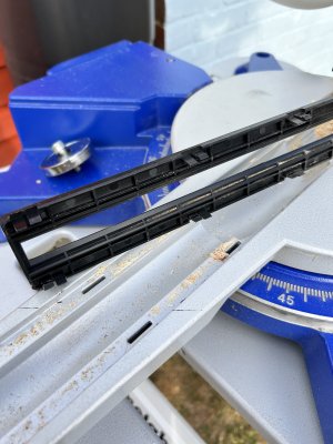

Just thought I would give you an update on what has happened… after hours of gentle manipulation and patience I managed to get the insert out without breaking anything. Had to remove the fence to do it but I done it.
Have attached a couple of pictures.
Now to make a new insert,
The old insert had a gap of 11mm… that’s huge… why it was made that wide I will never know.
Regards Darren

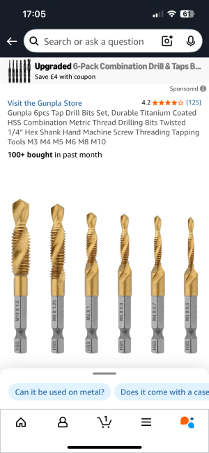

Yeah I think I’m inclined to agree with you there. Has anyone used these drill tap things before…. Never seen them before or used them.
I have some sets like that and they work fine. They aren't my preferred method, but in thin stock like the saw they'll be more than adequate. Just go slow so the threadcutter engages cleanly.
Depending on the material, in thicker stock I like to cut, back out a bit, cut, etc to stop the swarf from ruining the threads.
