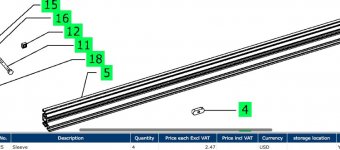

I am trying to identify a small part that came with my MFT/3.
It is a metal object a little over an inch long that slides into a slot on the MFT rail. It has a locking screw in the center. The ends are rounded.
The closest thing I found in the spare parts blowup is called a "strip". The diagram is too fuzzy to ascertain the part as being what I need.
I need to order 5 of these pieces for a project.
Help!

That sounds like the feather key (2 per mft) that are used as stops for the guiderail holding mechanism.  They are available thru ekat.
Here is the drawing from ekat and the part numbers (key and set screw) in case you are on a non java device:
Part number:  Key - 437377  screw - 772405
