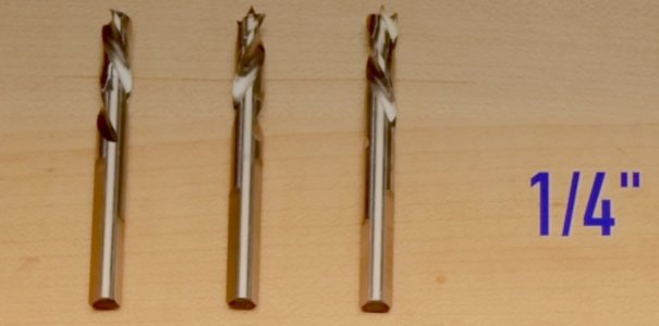

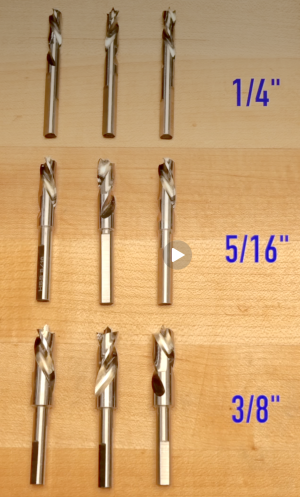

Another thought is that if the drill bit becomes dull, you'd likely want to replace all 3 drill bits at the same time as they're only HSS cutters. With each drill bit ground with a brad point end and the shaft having 3 ground flats at 3 different lengths, I'd be interested in finding out how much 3 new drill bits would cost.
