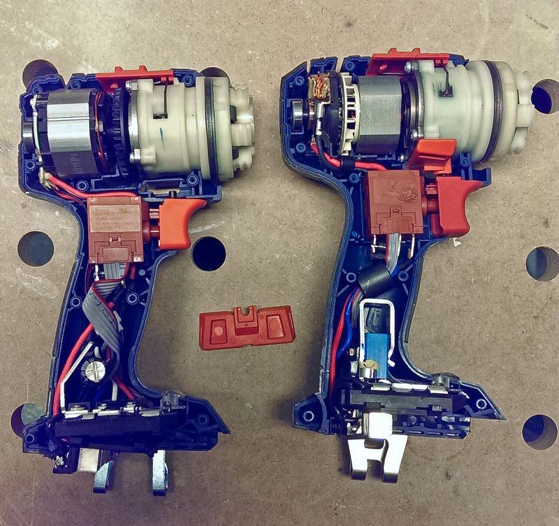

Ok, so here is how I ended up:
Ordered a GSR HX LI (solo) unit and did a swap over.
FlexiClick on the left and GSR HX LI on the right:
The HX Li has the previous grip with more rubber. The difference between the grips is not huge but the older grip is roughly a mm narrower and (surprisingly) almost a mm deeper than the new grip. The difference in use for me is more than meets the eye. Though it is still not that great with gloves on the older grip is better and feels more secure when working odd angles. Funny that a little rubber and a little variation in depth and width can have such an impact.
Judging from photos on the interwebz I figured that the first FlexiClicks were perhaps even based on the GSR HX LI machine and that a straight front plate swap might be possible or maybe even simply transferring the machine over to the other casing.
It wasn't all that easy since the brushless motor unit would not allow a straight swap and though it was actually possible to straight swap the front plates the FlexiClick fixture has deeper set front screws and for longevitys sake I thought it better to do it properly.
I had to open them up and swap over the internal plastic casing for the front chuck from one machine to another. All other springs and coverplates were the same and after a cup of coffee it was not to hard to put humpty and dumpty back together again.
In order to do this I had to forfeit the brushless motor for the better grip. The older unit I believe has higher specs and I wasn't too concerned about my voiding the warranties on the two units. Also, I got myself a brushless straight hex bit unit I will hardly ever use due to the poor grip.
After I was done I did a quick test with the conversion and ran four consecutive 127mm holes in 19mm mdf with the new FrankenClick with a slightly dull holesaw and ran the last three in second gear. The machine ran a little hot in the end but this is just about as much as I would torment a drill and it came through with flying colors.
I haven't tried the SDS attachment with the new motor fitting but I think it will do the job well as they have virtually the same specs with the older unit actually having higher NM on paper.
I am "ok" with the grip now but I hope they will release a slimmer grip or LI (Light) version of the FlexiClick. My unit was manufactured in 2014 so I think they might churn some new ones out eventually and if they come through I will pick up a new Solo unit and give away the brushless hex bit machine and keep this modified one as the wing man. :)
Last thing I did was to swap over the belt clips as well, the newer belt clip is a little longer and feels more secure though the old one was not bad. :)

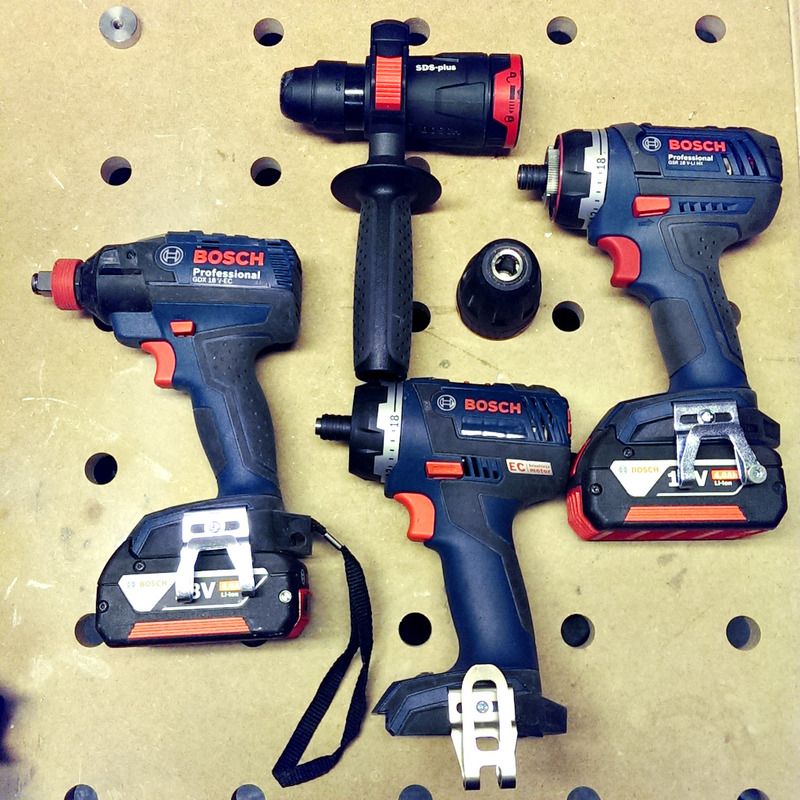

PS
Added the Impact driver in the comparison shot, the one I think has one of the best grips on the market. A FlexiClick with that grip... ...yes please.
Wow, nice swap! Interesting that the fan on the brushless model doesn't seem to have an exhaust port, I wonder how it works.
sae: it really moves some air I tell you. :)
The vent holes are fairly large and it does shift more air than the other model.
It has a black (air deflector?) collar, hardly visible in the image of the interior. I am not sure it spins but it might be distributing the air. It is not present on the other machine.
