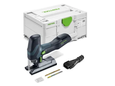

New jigsaw model just announced...
Made in China, apparently. Which I'm finding hard to believe given Festool's history with jigsaws. Maybe they're going down the Altendorf path, where their basic machines are made in China but the flagship products are made in Germany.
Stubled upon this comment from Festool Germany.
Considering it's made in China, sold at a 40% lower MSRP than the PSC 420 and they just low-key announced a 420 successor it'd make perfect sense if they tried to market it as a gateway drug into the system (as someone commented earlier on the PSC-E-designator; similar to the essentials-only T18-Easy drill)
