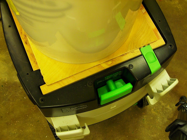

I just ordered another dust deputy yesterday to mount on top of the ct33 so I'll see how well it works soon here.  I dont have the boom arm yet but I want to male sure they will work together also.  I may make a board that clips in where the systainers clip to the top of the ct and mount the bucket to the board.  Im not really sure yet but time will tell.

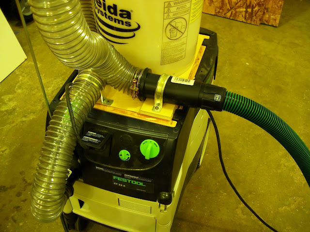

I have mine now mounted on a board that clips in the top of the ct33.  It's not too tall I don't think.  I have also added a short piece of hose from the inlet side of the dust deputy down to the board.  It is mounted on the board as well with a double female on the end (2 1/2 hose to 2 1/4 shop vac fitting).  That is where I attach my festool hoses.  This way if I pull on the hose it doesn't stress the cyclone with lateral pressure at the top Instead it just pulls on the ct since its all screwed to the board with a strap.  Also the fitting to hook the hoses is right near the plugit so the cord and the vac hose run side by side.

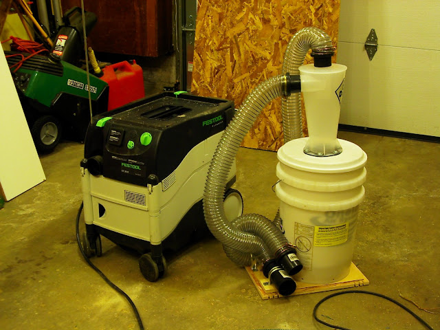

Here is my portable Dust deputy set up.  I comes completely off the ct for transport.  Has a separate hook up for the hoses so no stress is put on top of the dust deputy.  It can be connected to the festool boom arm.  It can also be connected to a wall mounted boom arm.  And remains easily portable.
Here is the Dust Deputy seperated from the ct
Here is the notched board to fit on the ct
Here is the unit latched into the ct
Hoses connected
Complete unit

Are you using the 27mm hose or the 36mm? When I tried using the 27mm on my older model steel dust deputy with the 1 1/2" tool port, it pulled the CT 33 down. I had to use the 36mm. Was wondering if the plastic dust deputy with the 2" tool port worked better with the smaller hose since it appears you are using the 27mm hose?

Les it seems to work with both hoses.  I'm not sure what you mean by "it pulled the CT 33 down"

Les,
I have 2 1/2 inch hose connecting the ct to the cyclone and the same going to the connector for the festool hoses.  Maybe that makes a difference.  I'll go try it out with a few different tools and see if theres a difference between the two hoses.
Edit:  Both hoses work fine no matter which tool I use.
