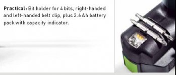

According to my information which is also taken from the "We will rock you" folder Festool has put on on their websites in Europe since last week. The new 2,6 Ah batteries have a capacity indicator and it's NOT on the body of the new models CXS and TXS.
So when using the new batteries on the old CXS you can have the battery indicator available because it's build in the battery.
It's also a complain about using Festool batteries on f.i. the Carvex or DWC that you cannot check the battery capacity while mounted on the machines because the 12/15/18V batteries itself have no build in capacity indicator.
Well that is awesome for the guy (or gal) that wants to keep his CXS! I really only have that one gripe and that's the fuel gauge. The larger chuck would be nice too. Hooray for Festool for allowing the CXS to be "upgraded"!
