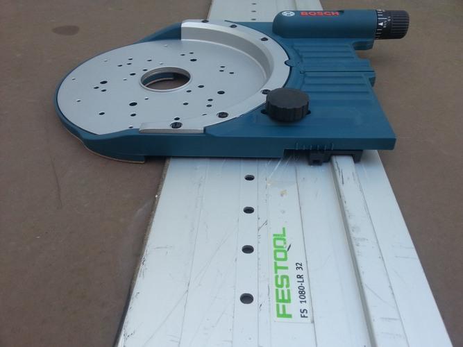

You could also do something like this with threaded rod, a home made adapter plate and Festool guides.  Works great.
[attachimg=1][attachimg=2]
