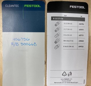

Is there a way to get a replacement for the old style connector? The 456756? Mine has degraded to where it will not stay on my Domino. I bought a new hose, but my Domino does not have the bayonet style port and the new connector is way too hard to push on. I can get it on to where one line is still showing the domino, but it still pops off at times. I have no idea what Festool was thinking here.
The 456756 was replaced by the 500668 at least 4 years ago. At the time, there was much discussion about the change and there was a mad rush to scour the internet to locate any of the older connectors. Your best chance now is to find an older Festool dealer off of the beaten track and see what dusty packages are still on the shelves.
