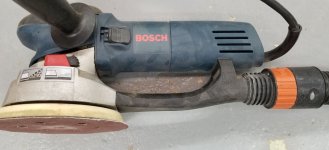

I don't know what to tell you. The Festool hose will not fit over the Bosch dust port. I really hate this sander.
This is what I am talking about.

That dust port does seem to be an after thought and looks like it would pop off easy even if you got it on there.  Plus with it being so close to the body of the sander it doesnt look like it would ever fit well.  Just bad design all around on Bosch.  As I said there are lots of negative reviews on the 1250 So, im not surprised you hate it.  You could try and use a heat gun to either make a pvc adaptor or to adjust the bosch ports diameter.  Either or isnt Ideal but it is an option.
However the newer model that replaced it looks much better and is reflected in the 4.5 stars.  There is lots of comparison videos on youtube between the Rotex and the Bosch.  I dont think I saw a single video that said the Festool was worth 300 more.  The dust port does look a lot better on the newer Bosch. [attachimg=1]
I really like Festool sanders and own several, but I dont think I would ever spend the money on the rotex over the bosch. I would sell the 1250 and take the 300 savings and get the ETS125/3

I have a 1250 and a Fein hose. When the rubber portion of the connector is removed, the ID of the remaining connector friction fits the 1250 perfectly. Never had an issue with it coming loose or falling off.

That Fein hose looks like it has the QA ends that pops on and off like the centec hose.  It makes sense since that's how I found the centec hose to begin with. My old r2d2 looking fein (not sure of model #) had a hose that was identical to the centec so much so either they make the hoses for fein or they source them from the same place.
I use a mix of dewalt, makita and festool and this hose has fit everything. Including my Krieg foreman.  Im a fan of it.  If you have a range of tools with different dust ports.  I will probably still get a 27 festool hose for that will be dedicated to just my sanding station and ol faithful will stay as back up when I use the other brands. I coverd mine with the PET covering to prevent snagging and its worth the upgrade.
