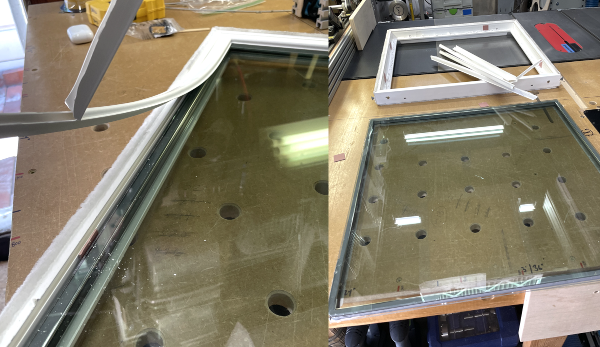

Hi, is there a glazing bead on the other side? If so that should pop off, then on the side you have showing cut the silicon bead that hold it in.
I was able score the plastic bead on the other side with a utility knife and pop them out. A thin putty knife was able to slide between the vinyl and the glass on the other side to break the silicon bead. Took less than 10 minutes.
Thanks to your reply, I took a much closer look at the window rather than attacking it with the methods mentioned above. Thank you!

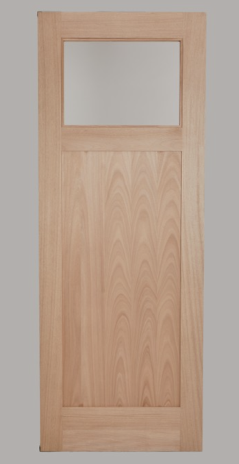

I'm thinking of building a door similar to this:

4nthony said:
Both panes of glass in this window are 1/8" thick. Total window thickness is 7/8".
I've done two just like this so far for my house, one more to go. Domino tenons all the way.
