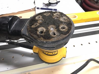

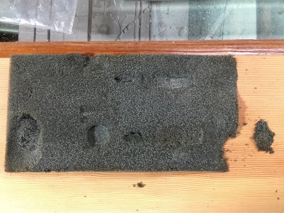

Anyone that uses foam in their products owns this issue:
1. Here's a piece of 3/4" thick foam that's used to protect machinist tools.
2. A Dewalt sander that lasted about 5 years.

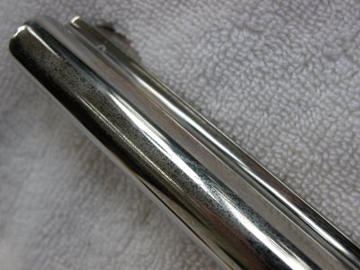

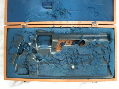

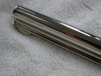

3. A S&W presentation gun case made from mahogany with a thin foam liner for the gun to rest on. This last item is really unnerving in that you pay a premium price for the gun case to protect the firearm, gently place the firearm inside and then 5 or 6 years later you open the case and find the foam stuck to the gun. The deteriorated foam actually attacked the nickel plating... 😵‍💫 ...not good.
4. The side of the barrel that was laying on the foam.
5. The underside of the barrel that was not touching the foam.
