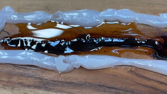

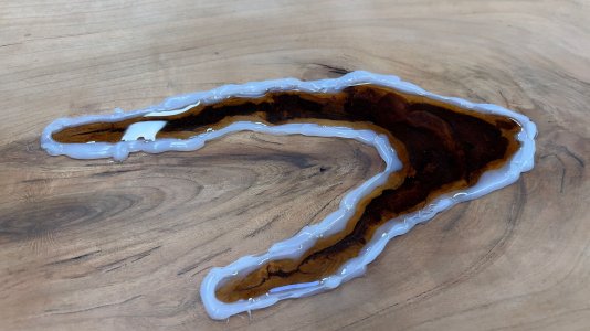

Thanks for the toothpick idea. I've read that mixing small batches is tricky as getting the proportions of resin and hardener right is more difficult and you might have too much of one or the other.
When you do it you'll need to approach the holes from the side with the toothpick, and let the resin flow in, otherwise you'll trap another air bubble that may not break through.

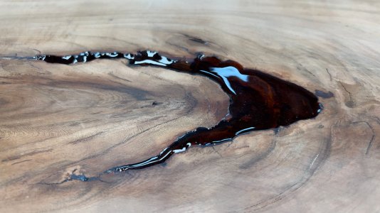

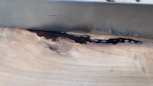

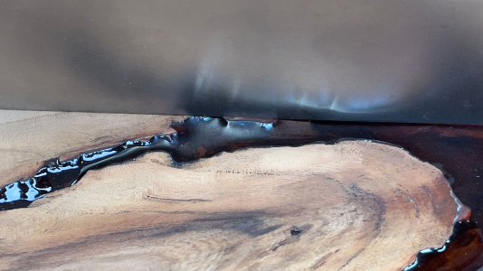

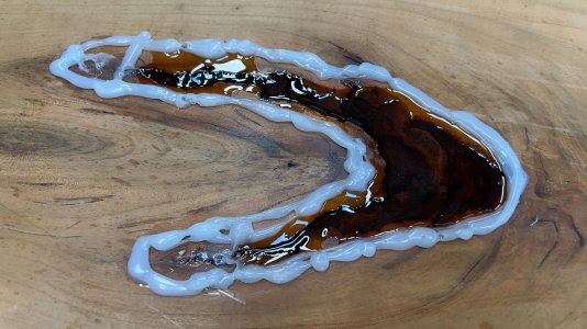

I did a coat of CPES almost a week before my first pour, which should have sealed everything well. I think the bubbles occured during the second pour - maybe I didn't take enough time with the heat gun.
Colder temps or short working times can make the resin more viscous, which makes it harder for bubbles to rise and pop, warming it up in a container of warm water can help to make it less viscous and easier to get bubbles out.
Other times it could simply be the result of a pocket underneath somewhere that releases the air some time later, so it doesn't rise all the way.

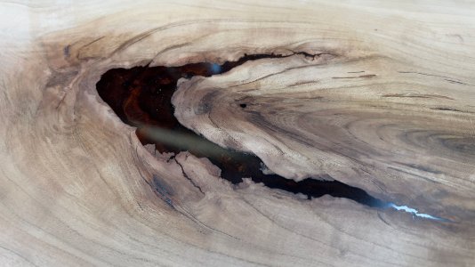

I think you're right though with the heatgun, if I zoom into the earlier picture there's quite a lot of bubbles along the timber edges, so they must have just kept appearing. It's a battle some days! ;-)

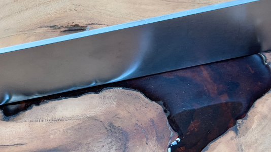

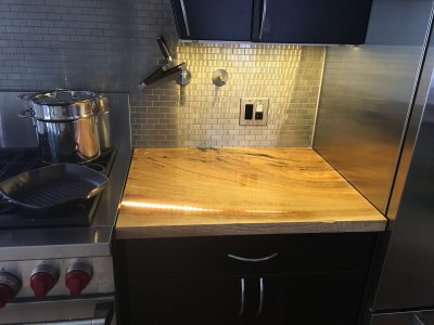

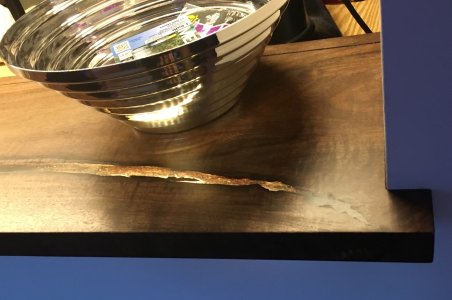

So, here's what the third layer sanded down and quick polished looks like:
Not too shabby. My wife likes it so much she's asking me to fill some of the other smaller cracks in the knots and such.
I heard back from TotalBoat. They:
1) Claimed that I probably didn't seal the wood with the CPES well enough, should have done 2 coats, and so some of the first layer epoxy seeped into the wood.
2) Says that the ThickSet I'm using is fine for ½"-2", but for thinner coats I should really be using the TableTop version. So I've ordered that.
BTW, they make a Fantom for thicker than 1.5" as well.
