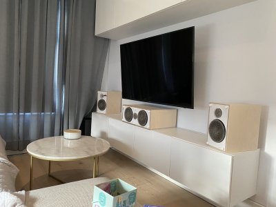

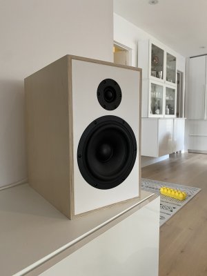

I had the chance to listen to the Solen Mura 5b. The store is a short diatance from ma house. And the guy that designed it is pretty cool. The small-ish speaker that packs a punch. From my ears, at say they’re about 80%-85% as good as my CSS audio criton 1td and 2td. On for home theater uses, it’ll be good enough.
Attached picture of said 1td and 2 td’s

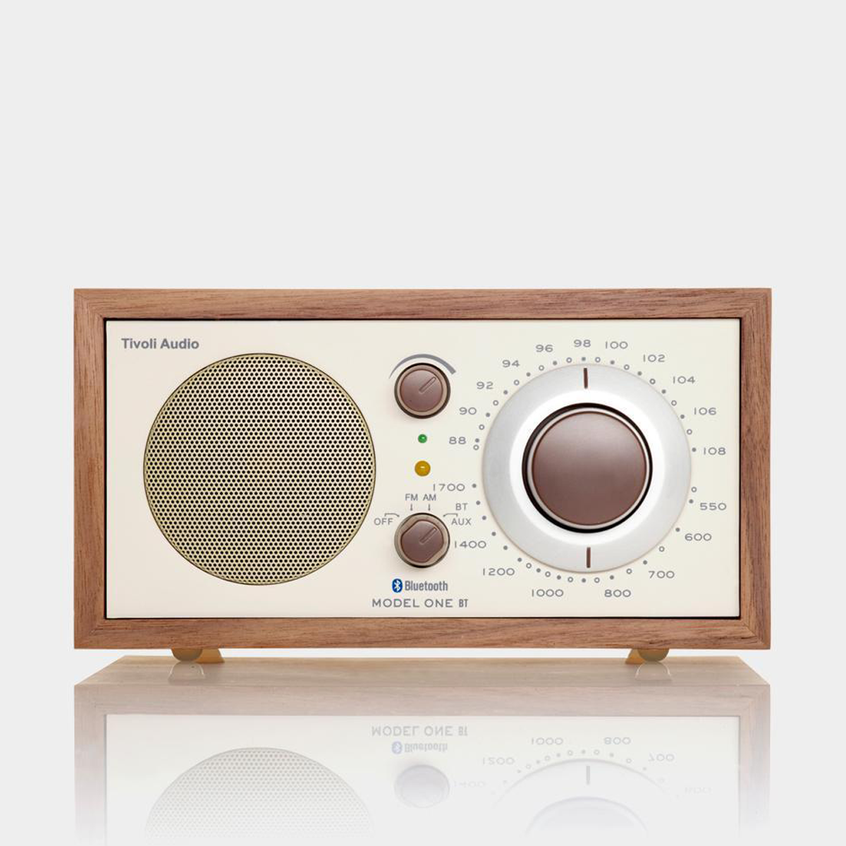

My 25 year old Tivoli Audio radio has remarkably nice sound out of an appropriately 4” speaker and a 5” x 10” x 8” box. Those are appropriate dimensions and I will update when I locate the radio.
That radio is the reason I think acoustic engineering plays a big role in how a speaker sounds. A radio that small should not sound that good.
Addendum:
Still in production, and smaller than I remembered. Updated dimensions: 4.5 x 8.375 x 5.25 in
And apparently they have added blue tooth, which mine does not have.

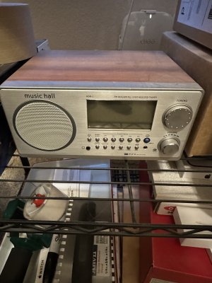

I have the Music Hall model, they do sound great.

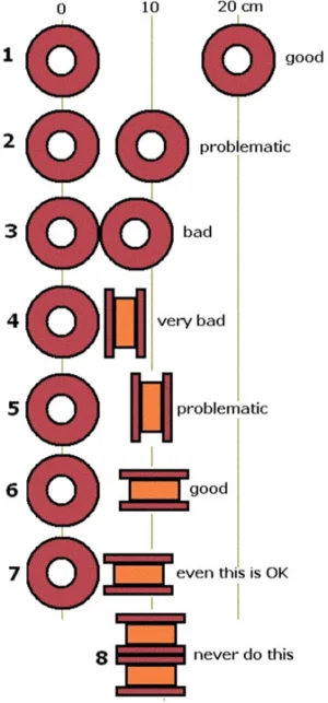

What determines if the inductor coil is mounted flat or is mounted vertically?
I could be wrong, but I guess it’s the place on the board.
Edit: I was wrong, here’s the answer I found :
Coils have a magnetic field. Neighbouring coils will be affected by this magnetic field. To minimize that they should be mounted at 90 deg. to each other.
Thanks for that...now that makes sense. :cool:
So, for a 4-way crossover you'd probably mount that on 2 separate boards and space them at some distance from each other inside the enclosure.
So answering my own question, I found this example of proper inductor orientation.
I think it depends on the power in watt of said speaker. I read that 5 watt speaker you wouldnt here the difference, but 100w speaker its important.
