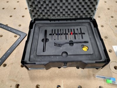

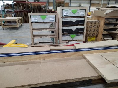

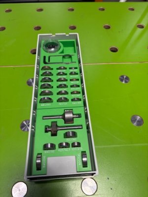

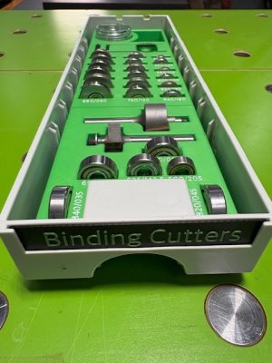

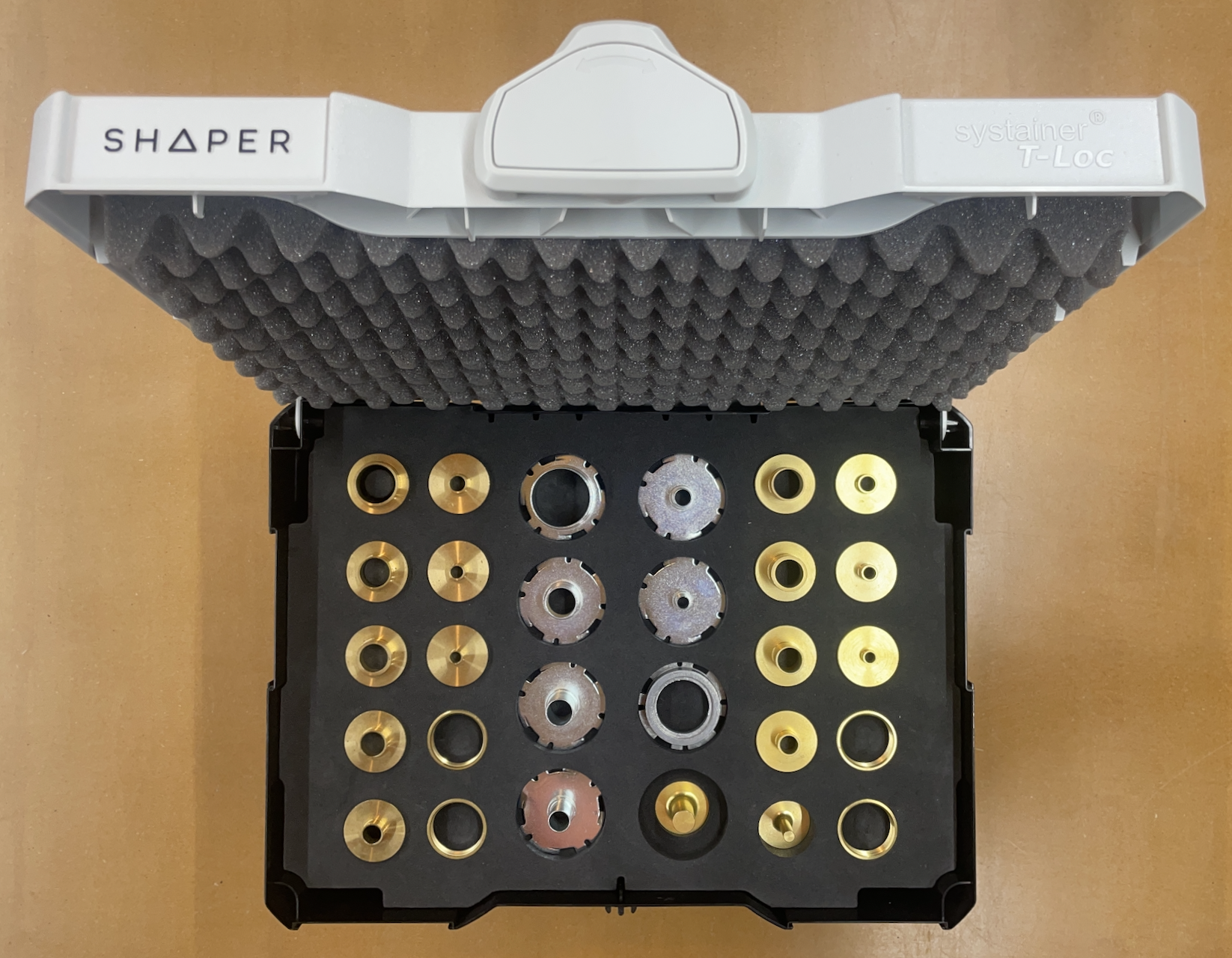

I seem to be accumulating Sys Minis, so I made another case to contain them. They will eventually end up on a cleat wall in my garage shop.

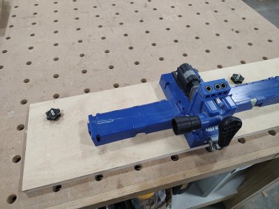

The newest is from Bow Products. Their new item, called "Pack of Dogs" comes in a foam inert that fits the Mini Sys. It is a set of 6 expandable dogs, that act as mounting bolts for MFT holes. So far, I put a pair into the board I use for the pocket screw jig. Next is going to be the Shaper Workstation

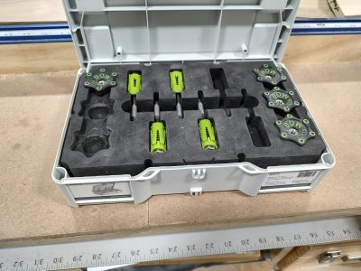

I did get a few of the full-sized foam pieces, the one time I saw them available. So far, I have only cut into one of them. Strangely enough, I just added to that one today. While I had it empty for the procedure, an idea occurred to me.
The space under the Trace frame could be used too. It's a very shallow pocket, so router bits, an Exacto knife, short ruler, etc could fit under it. As far as that goes, it really wouldn't even have to fit completely under it? As long as the pocket was deeper, it could be partially visible.
Recently I saw the same foam sold as 24" x 48" sheets, but I would have to figure out how many I could cut from a piece, of that size.Shaper Sysb.jpg
