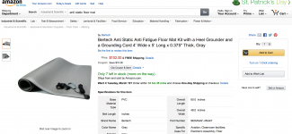

Maybe Festool should sell this......
[attachimg=2]
[tongue]
