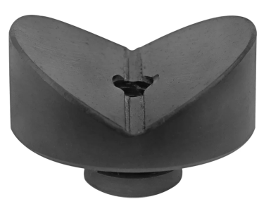

Maybe dog holes in the side verticals so you could clamp something upright? Especially given that you have a lot of clearance below you. As for a V-groove, make yourself something like this:
They are called V-blocks and that's a dog in the bottom (for 5/8" holes common in some welding tables). It would be trivial to make some for an MFT top out of wood.
