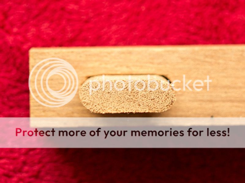

Spent the morning making 100+ accessories for my DF700XL

I've got an outdoor project (Garden Door) underway and needed some outdoor use dominos. I could have bought some SIPO ones but decided to try to make some for myself.
As the door is being made from planks of Iroko I decided to use up some of the offcuts to make the dominos.
I sized them to fit the larger of the 2 widths available on the 700XL and to make them a bit longer than the standard ones so I made them 8mm x 24mm x 60mm and used a 3/8" radius round over bit to complete it. They look quite good but I will chamfer the ends and maybe scratch a pattern in them when I am ready to fit them.
I have fear about these DIY Dominis, because Real dominos are dried and compresed. I hope that, this dominos will not change shape.
Sipo Dominos are wery  expensive,  so I use basic dominos with lot of D4 water resistanat glue.
Sorry, my english isnt good
EDIT: For my basic diy projects i use all time basic domino. For client sipo.
Your English is better than my 'any other language'.
bnaboatbuilder said:
Those should work just fine. Tenons have been used for centuries without "patterns" on them. As long as there is the smallest space for glue on the edges, I see no issues. Nice job.
Thanks, I was advised this was the most cost effective way to get outdoor dominos.
