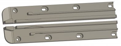

Here's my attempt at the rails. These definitely won't fit on my printer, but I'll slice them in half (and glue them) and give them a try tomorrow. Festool uses glass reinforced PolyMide (nylon) for their rails, so I'd suggest something stronger than PLA if you're 3D printing them.
Cheers!
P.S. This has been printed, corrected, and reposted as of Feb.10, 2024. The link below is now updated :)
SYS3 Rails .STL File
Notes: The SYS3-SN/4 rails are embossed with width dimensions for mounting. Inner carcass width for the "M" size is 418mm (16-29/64in), the "L" is 530mm (20-55/64in) and they recommend a 13mm (33/64in) gap from the top and bottom of any rack or cabinet you're installing them in.
