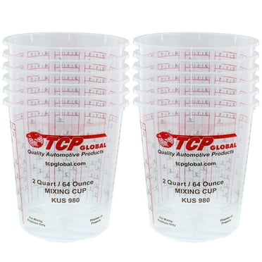

I do recommend you get some mixing cups and lids.  You will find them very handy.  I got the TCP cups from Amazon.com.  Very cheap.
Get the ones with a few lids and also a pack of tongue depressors to stir the paint in the cups.
