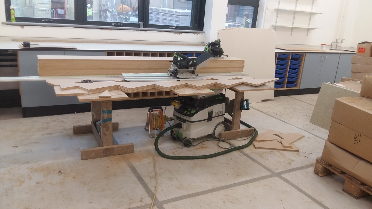

Pair of sawhorses, 2 bits of 2x whatever timber on them and several bits of mdf/ply/2x2 running at 90 degres to the first timbers.
Dead easy to move about, the extractor fits underneath it all and it works.
