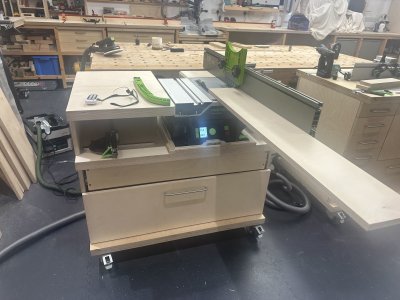

I love that cart! So damn useful.
When I build the next shed to store the timber in, a cart to extend the rip capacity for the SYS 50 will be on my list of urgent projects!

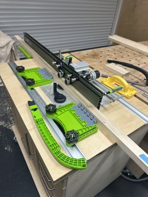

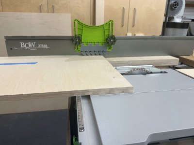

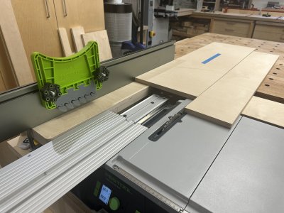

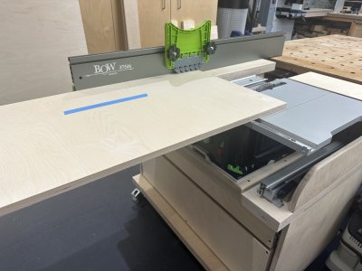

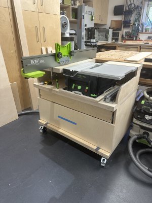

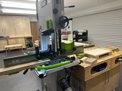

No not difficult to move, as a extended fence on the right side it’s easy to connect to the Festool fence with a couple of clamps and useful to provide addition support from longer stock.
On the right side I found that first cutting a scrap piece to the width I want using the sliding table and clamping it to the sliding table gives me a perfect reference point to set the BOW fence as using the sliding table I have multiple reference points to set the fence up and can test its parallel to the blade by sliding the clamped test piece up and down. This gives me confidence re safety and accuracy. Then remove the test piece and lock the sliding table. This arrangement is only for longer rips than the sliding table can support so it’s not needed and gives a little extra support for the front of the blade if needed. This then gives a rip capacity wider than the 280mm on saw as delivered.
Given the cart size I can now support long rips up to 625mm which has been really useful …. But I’m a small hobby shop so I’m not doing it all the time and only occasionally but it’s a useful feature.
If I don’t feel safe I don’t do it and revert to a a track saw. But this is a happy medium ….. I use the same BOW fence in my router table and band saw depending on what I’m doing so think its really good value and the feather boards are really good tooIMG_2126.jpegIMG_2114.jpeg
