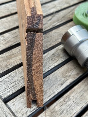

We've launched a new blade for the Kapex. It's a 36-tooth blade made for thicker, tougher stock that often burns with a 60 or 80 tooth blade. Personally, I was skeptical when this came to my desk, but when I took it out in the shop and started working on images and video, I was impressed. The cut speed is very impressive, but that usually means the surface finish suffers. In this case, the finish is almost as good as any high tooth count blade I've used on the Kapex. The video shows me dropping the blade through 3" thick hard maple, and I didn't go as quickly as I could have. Feed resistance is absolutely minimal.
