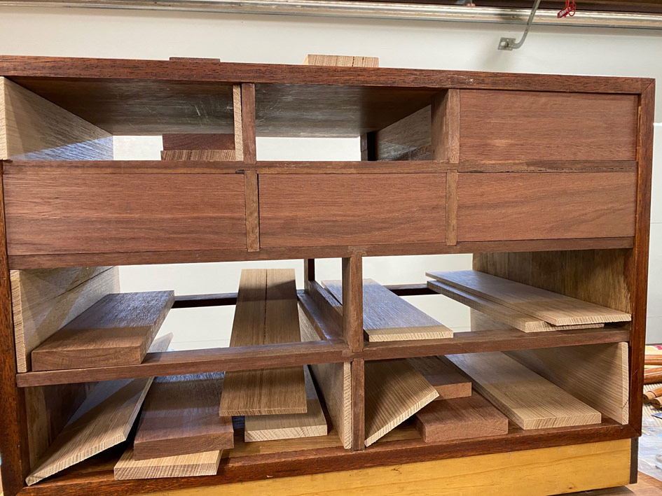

It seems so straight forward: build the case, insert drawer frames and dividers, and build the drawers.
Each step actually requires planning ahead. The devil lies is in the details. These are some of the details we take for granted ...
Step one is to plane the fronts of the rails and dividers, and fill in any chips with tinted epoxy.

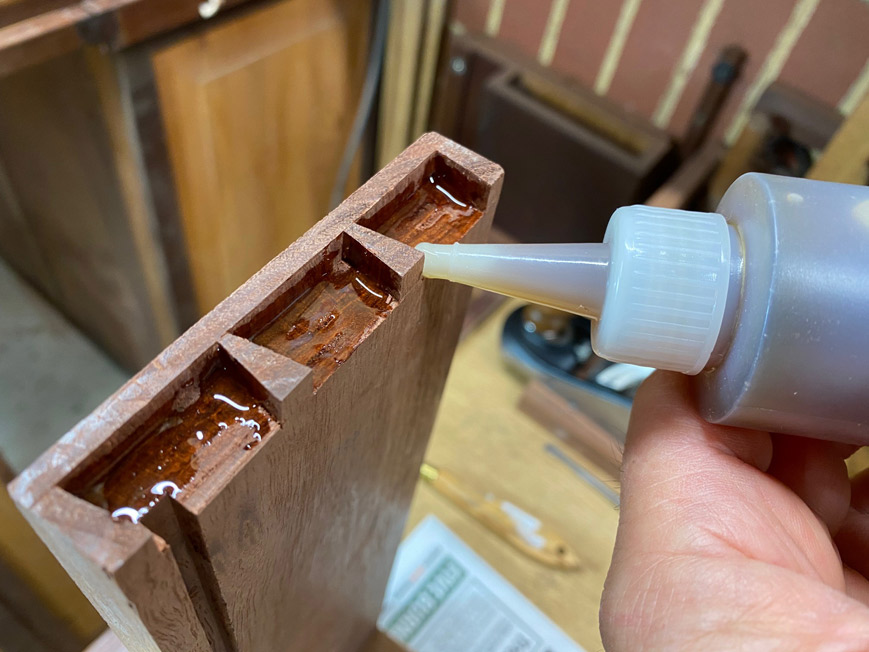

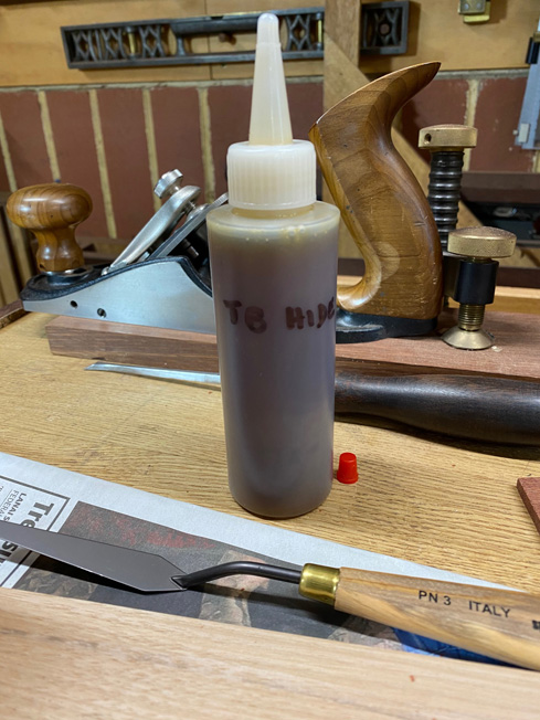

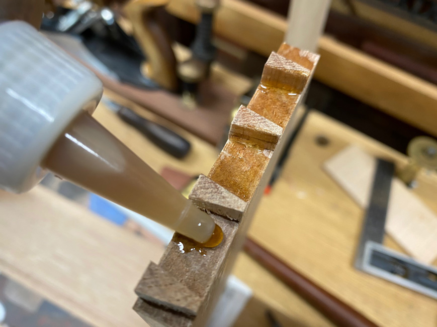

Even gluing up requires a strategy when the case includes blind sliding dovetails: glue these first.
The benefit of liquid hide glue is extended open time and repairability. I hope that I do not have to make any repairs, but I could do with the open time as it is 40° Celsius today (that's 104° Fahrenheit). I like a small spatula for placing glue where it needs to go.
Glue the first set of blind sliding dovetails, and then the other set ...
Finally glue in the other dividers ...
Lastly, add the drawer guides. These are just glued in. The spring clamps centre them.

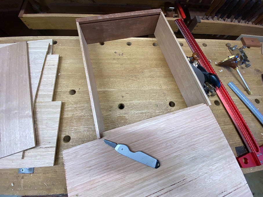

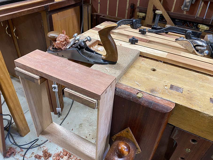

Once all this is dry, we start to prepare the drawer cases. Each one of these needs to be square at the sides and parallel all the way through.

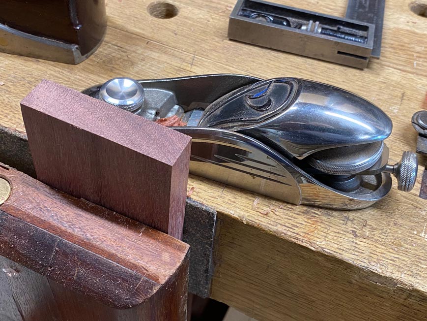

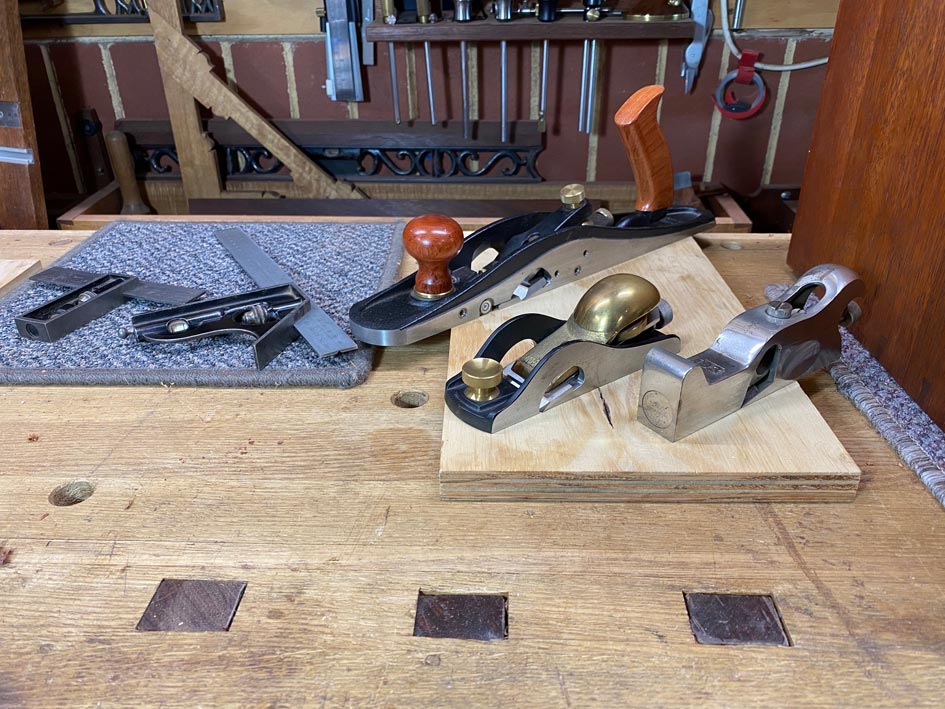

The planes I find helpful are these: a rebate jack, a rebate block plane, and a low shoulder plane ...

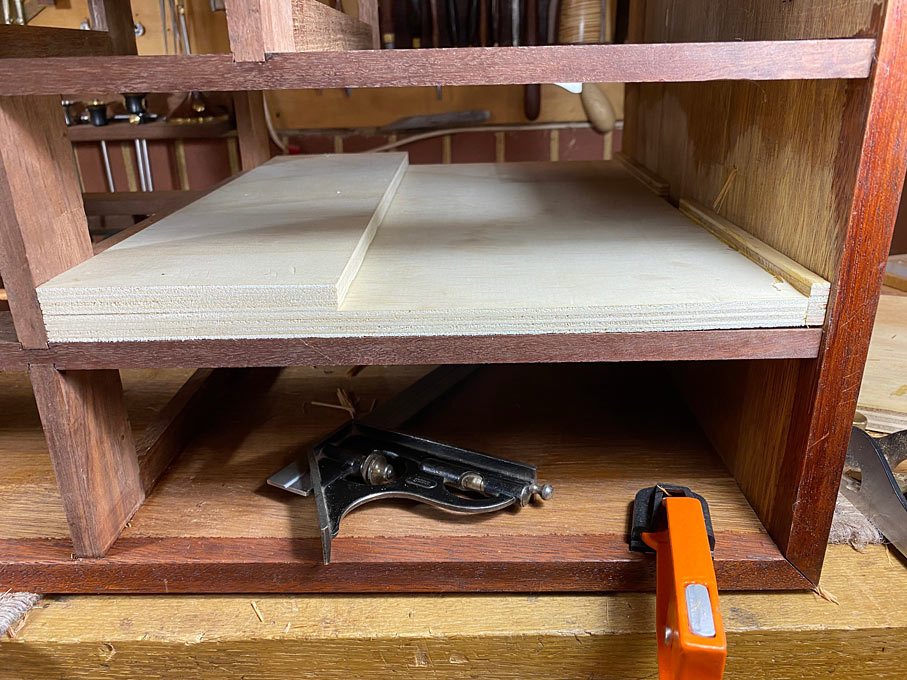

For each drawer case there is a drawer-sized insert, generally of MDF or ply. A couple of cross lines aids in determining whether the drawer will be square to the sides.
The "drawer" here does not enter more than an inch or so ...

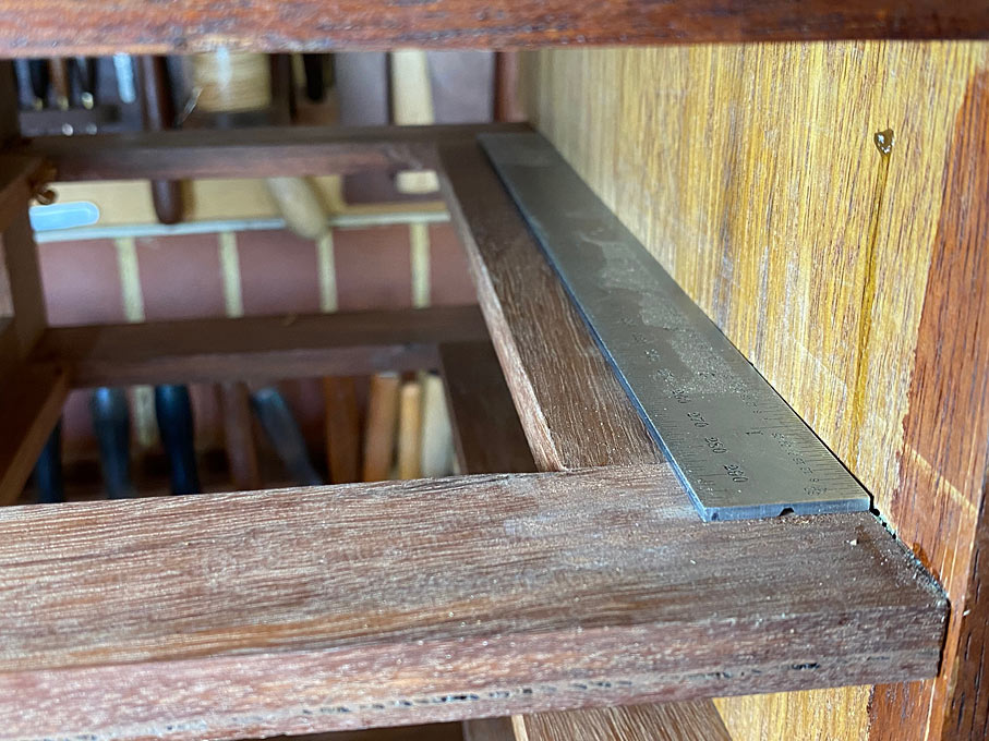

A straight edge along the side reveals that there is a bow ...
The block plane takes this down ..
... tested with the insert. Looking better ...
A little more planing ... and the insert moves tightly, but smoothly all the way back-and-forth ...
Every drawer case is dealt with this way ...
Square edge ..
Planing ..
Square and insert ...
Square and parallel and square ...
Every drawer case is tuned this way.
Now we are almost ready to make drawers :)

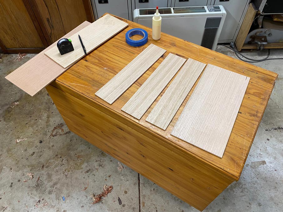

So what do we need to do today? Well, we need to cut the drawer parts (minus the drawer bottoms) to build the drawers  :)

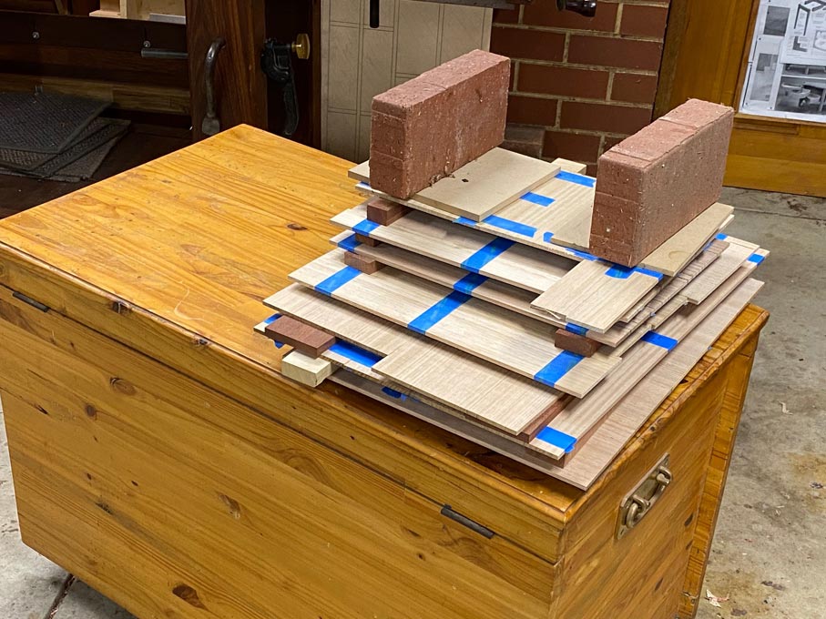

I spent time selecting the wood for the drawer sides and drawer front-and-back. The sides were jointed and thicknessed by machine, and then stickered for a few days ...
The drawer sides are to be 7mm thick, which is more typical of the drawers I build for furniture than a tool cabinet, however the drawers will each house a tray - some sliding and some cantilevered - which effectively doubles the thickness. My aim is to be sturdy but also save space (since the tool cabinet is on the small side, as it must fit under the work bench).
The drawer front is 18mm. The drawer back is 12mm.

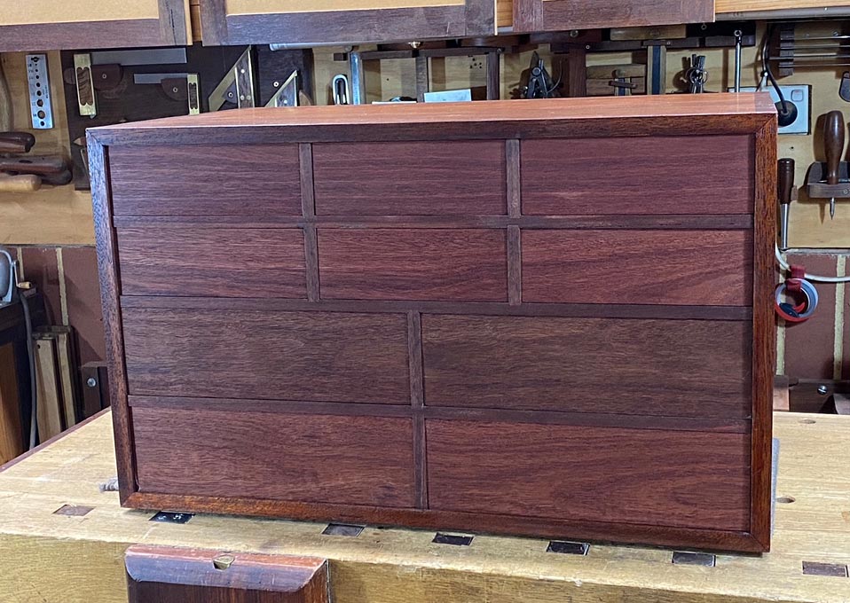

For reference, mentioned at the start of the build, the dimensions are:
Dimensions: 660mm x 400mm x 400mm (26" x 15 3/4" x 15 3/4").
Small drawers: 205mm x 70mm (8" x 2 3/4")
Large drawers: 305mm x 95" (12" x 3 3/4")

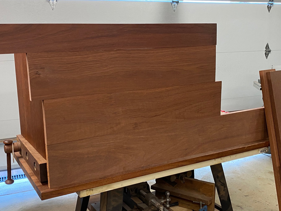

Time was taken to select the wood for the drawer fronts.
The issue here is that I was not after figure, but constancy of grain and colour (although a little tinting could be done with a latter). Lots of combinations tried ...

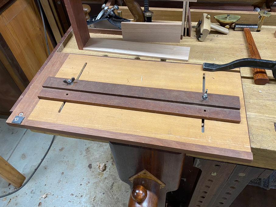

Now to the fixture. Actually, there are two fixtures.

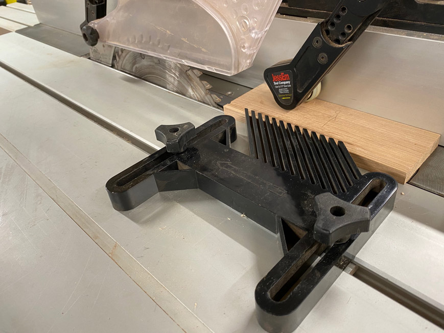

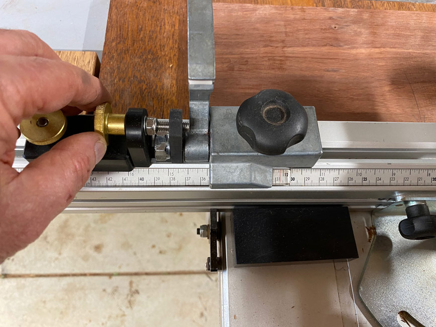

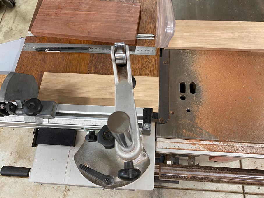

I recently posted a design for a Parallel Guide for a slider table saw (mine is a Hammer K3). This article is here:http://www.inthewoodshop.com/Powered Tools and Machinery/ParallelGuideForK3Slider.html
The other design I posted was for a Micro Adjust for the crosscut fence:http://www.inthewoodshop.com/Powered Tools and Machinery/CrosscutFenceMicroAdjust.html
These new addictions made sizing the drawer fronts and backs much easier, and quicker.
Generally, I would rip a board to rough size for the drawer front (and back, since they must be an exact copy of each other), and then fine tune it with a shooting board and hand planes. Well, these tools continue to be used, but I can get pretty close to final dimensions on the slider alone. The parallel guide replaces a rip fence, and it is both safer to use as well as leaving a cleaner finish than off a table saw rip fence.
Here is the crosscut fence cutting the width of a drawer front ...
With the use of the Micro Adjuster, it is possible to sneak up on the width and "shoot" it with the table saw, to such fine tolerances only previously capable on a shooting board ...
Minute adjustments can be made to the cut, with the aim of a tight fit side-to-side.
Once the drawer front is done, it is a simple matter to cut the drawer back using the same setting ..

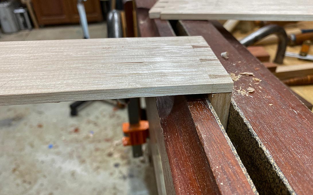

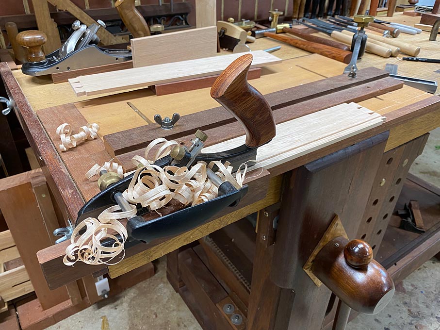

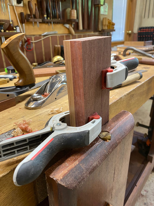

Once all are done, comes the time to tune each. The main tool use for the upper edge is a shooting board ...
Ensure one side fits smoothly ...
... and the other ...
The ends need some tuning as well. This is to remove a smidgeon here-and-there, to ease a section where the sides may be touching or even jamming. It may require a shaving, or just dust. The tool of choice here is a block plane.
My aim here is a smooth fit - not loose but not tight: at the end, after the dovetailing is done and the sides are glued together, I want the drawer to dry in the drawer case. Therefore, it needs to be able to fit. I expect to do a little tuning still, but the aim now is to prepare for this fit.
The drawer back needs to be tuned up identically to the drawer front - the smidgeon "here-and-there" included. So, clamp the parts together ...

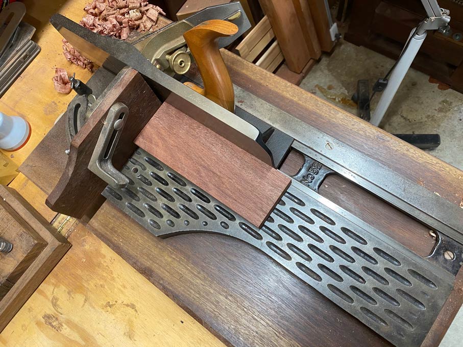

Rip it ...
Test the fit in the drawer case. Any tight spots can be removed with a shooting board or block plane. This is what we are after ...

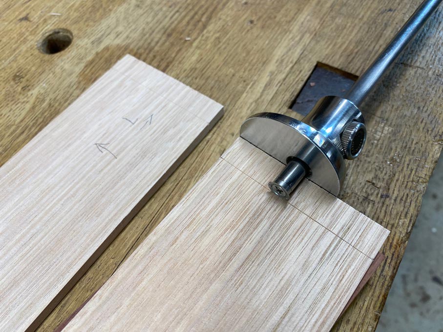

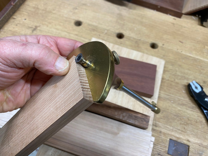

The inside face of the drawer sides is planed to remove any machine marks ...

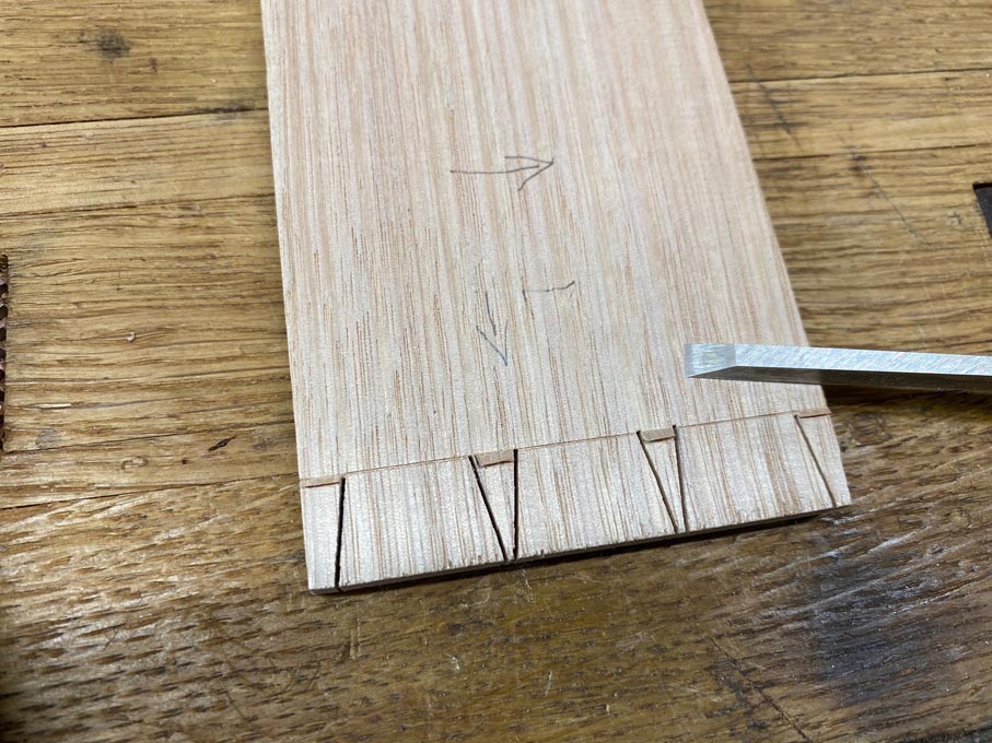

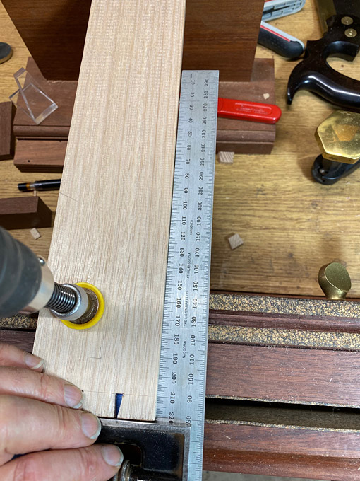

We will cut Tails First, so mark the tail board ...
To speed marking of the tails, a template (or story stick) is made. This will set out the tails for the top two rows, six drawers in all.

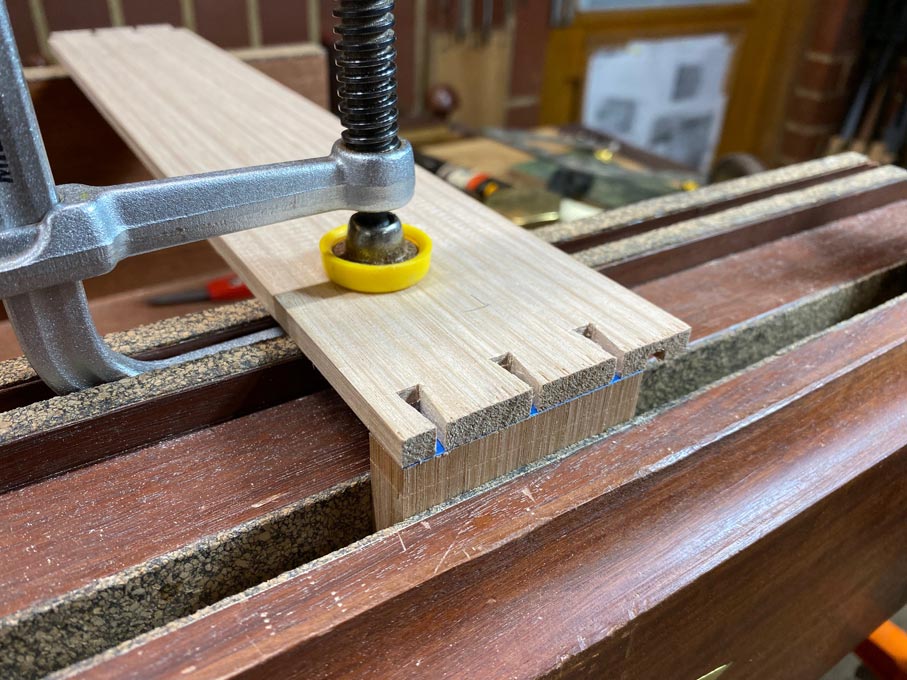

The tails are sawn. Note that there is a line of blue tape to help my aging eyes know when to stop cutting!

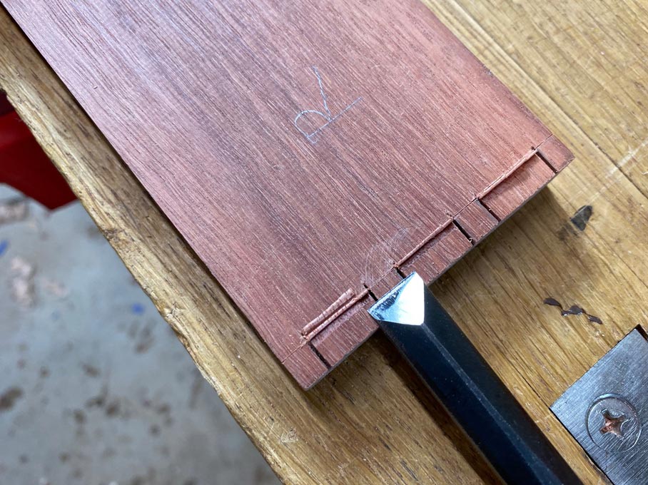

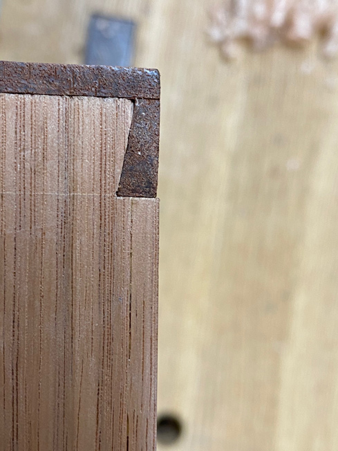

An important step is to undercut the baselines. This will increase accuracy when paring ...
Fretsaw the waste as close to the baseline as possible. I generally leave about 1mm ...
Saw away the half sockets at each side, as usual. But now possible to set the chisel in the chisel wall and use a single down stroke to sever all the waste in the internal sockets, leaving the tail board done.
Mark the web on the drawer front. For 18-19mm drawer fronts, I keep make this 5mm wide.
Once again, to aid visibility, blue tape is applied to underline the baseline ...
... and the pins. Here it extends to the web line ...
This next bit is extremely important, and can make-or-break the final result. The tails are transferred to the pin board. A single bevel knife is preferred. This will hug the wall of the socket, and slice the tape in a single stroke.
Secondly, the tail board is held firmly by a clamp, and is positioned squarely using a combination square. The square is placed along the reference edge, which is the lower edge of the drawer side. This will switch when the other side is marked out. The importance of this technique cannot be overstated: a squared joint is a prerequisite for a perfect fit. Anything that is not square will require planing, and a lot more tuning.

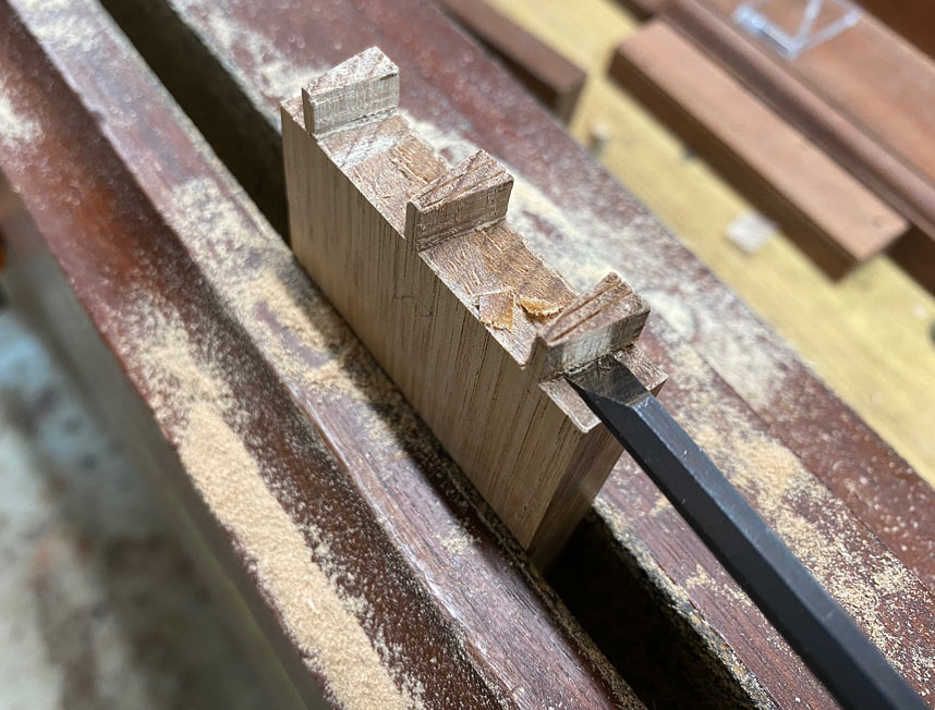

Another time saver comes in the form of deepening the kerfs. This is my version of Tage Frid’s scraper method, a “kerfing chisel”.
With the kerfs deepened, remove all the blue tape, and deepen the base lines ...
Undercut the baselines to create a chisel wall for each socket ...

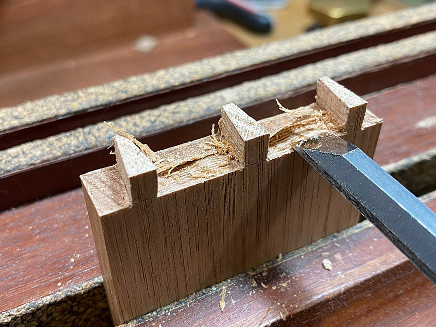

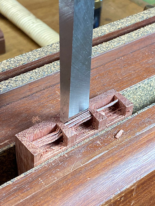

Chisel in the chisel wall and three moderately firm hammer blows. The chisel wall prevents the chisel moving backwards and over the baseline. This means that chiseling can start at the baseline, itself, and reduces later extra paring ...
Split out the waste ...
With hard Jarrah and a decent Japanese chisel, it takes me three rows to get within 3mm (1/8”) of the web line. I stop at this point ...
This is repeated at the other end of the board ...

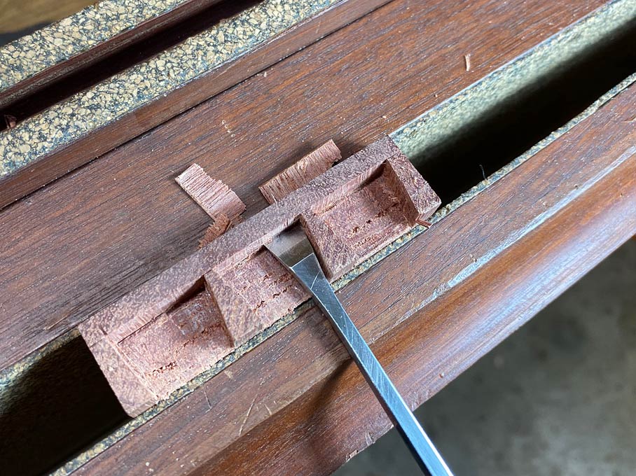

Back to the Moxon Vise: the sockets are cleared by paring the remainder in 1mm slices ..
Cleaning out the socket was facilitated by earlier extending the kerfs, and now with a corner chisel ...
It is all about “release cuts”, as David Charlesworth has written in his articles over the years. Create a release cut, and waste will fall away without a fight. The deepened kerfs mean that there is no further paring needed at the sides of the sockets. Clearing the waste is a matter of splitting it out. The chopping is a release cut here.

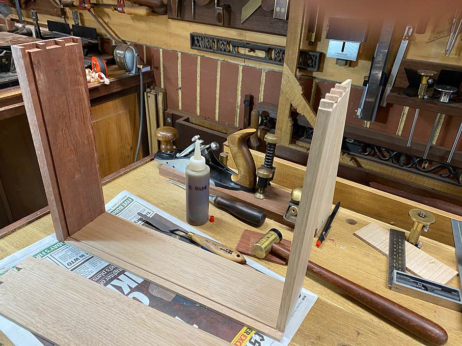

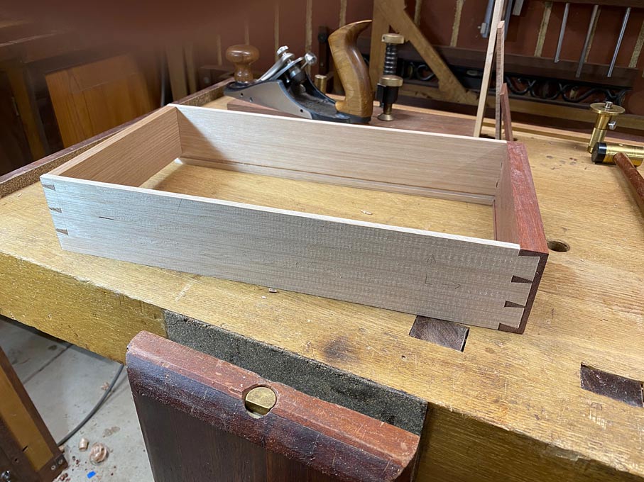

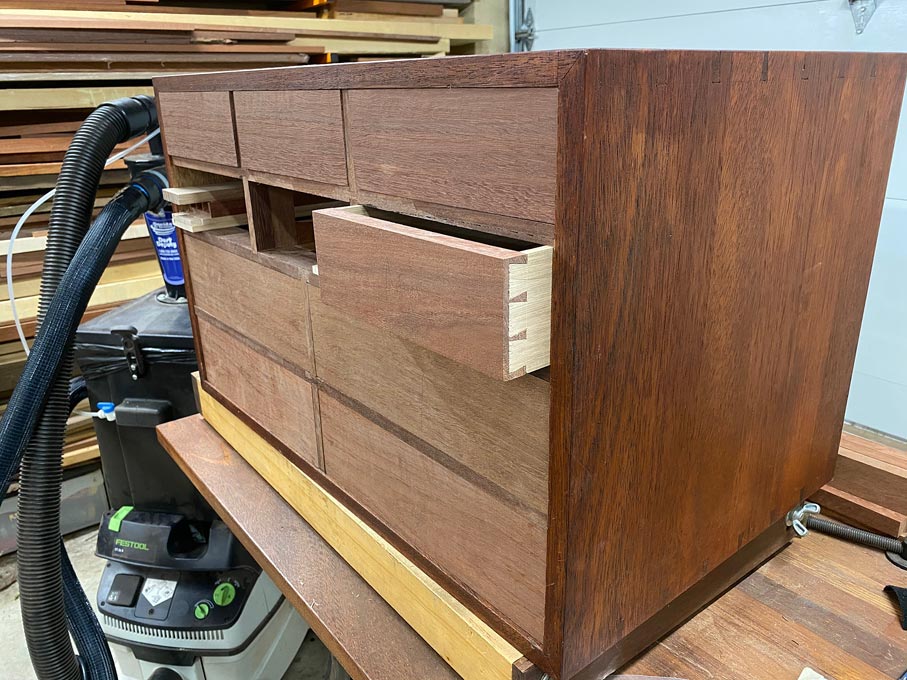

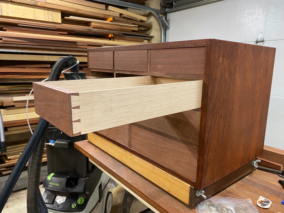

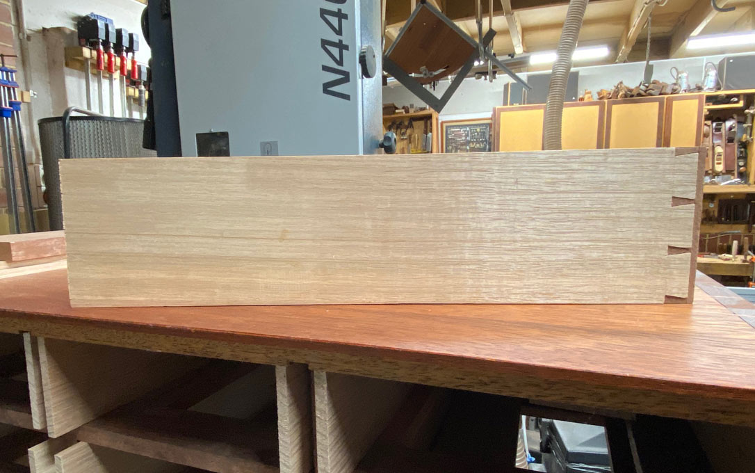

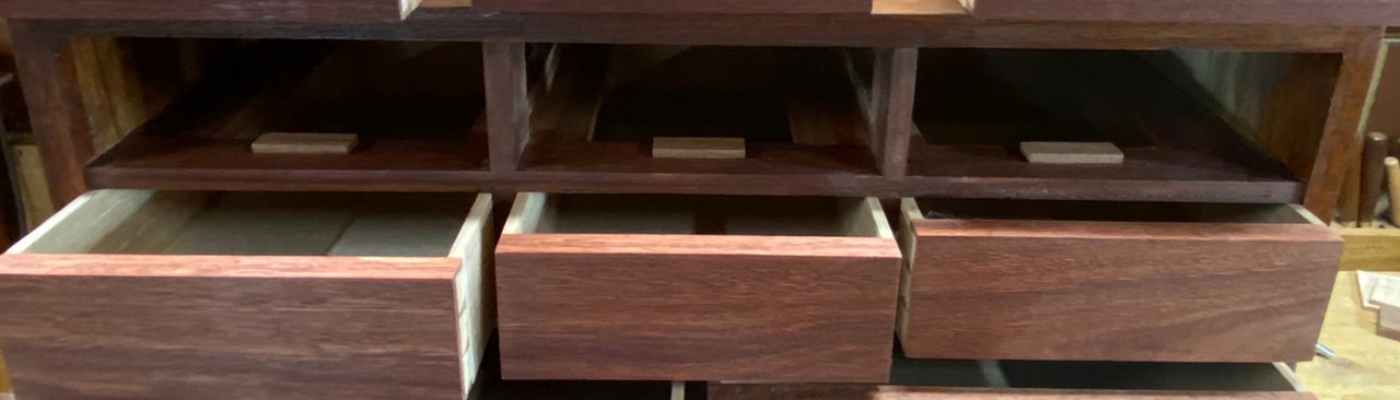

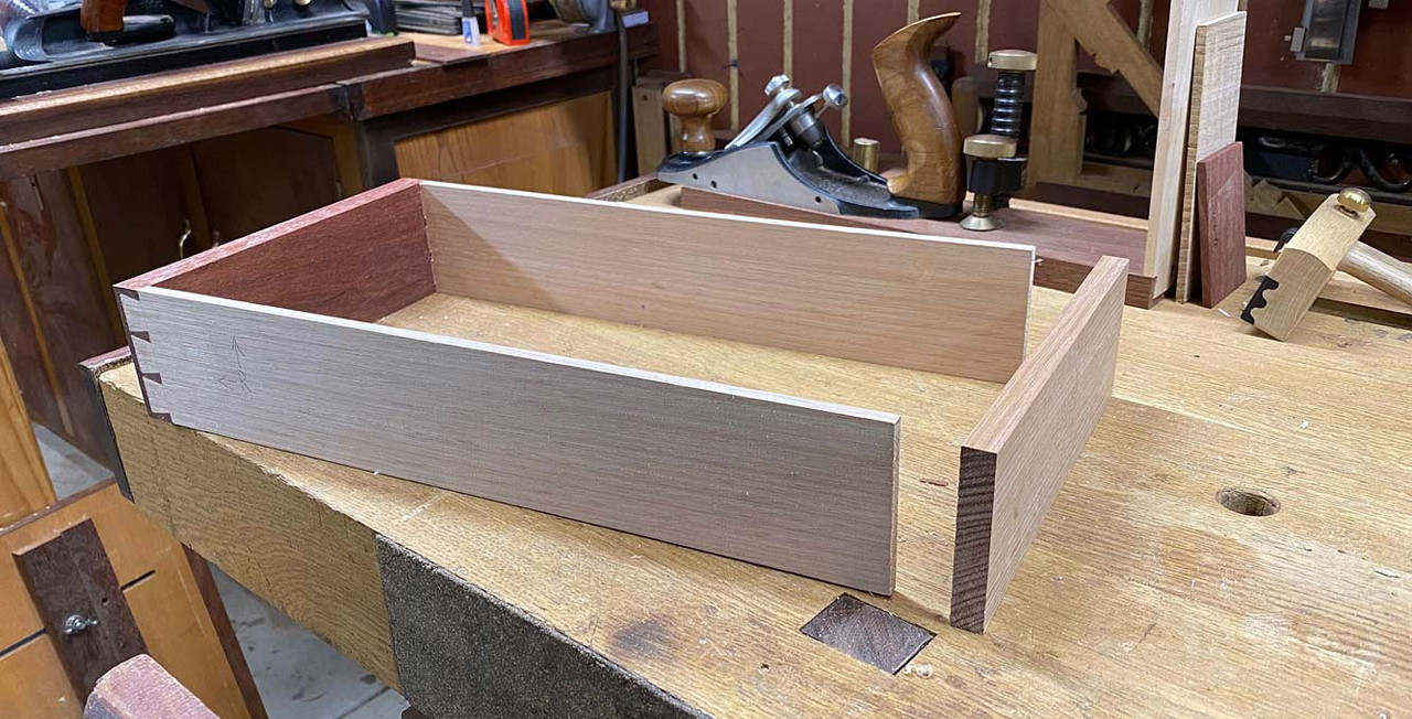

Finally! The dovetailed sides are tapped into the sockets of the drawer front. The goal here is that they fit “off the saw”, and no further work is needed? Note that the small section here does not only protect the surface, but it ensures it is driven flush ...
How did we do? Here is one side ...
And here is the other side with the “drawer” inserted into the drawer case ...
The drawer can be pushed flush into the drawer case, which was the target at the start ...

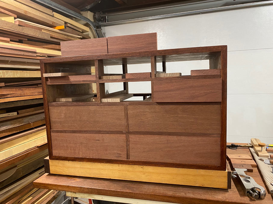

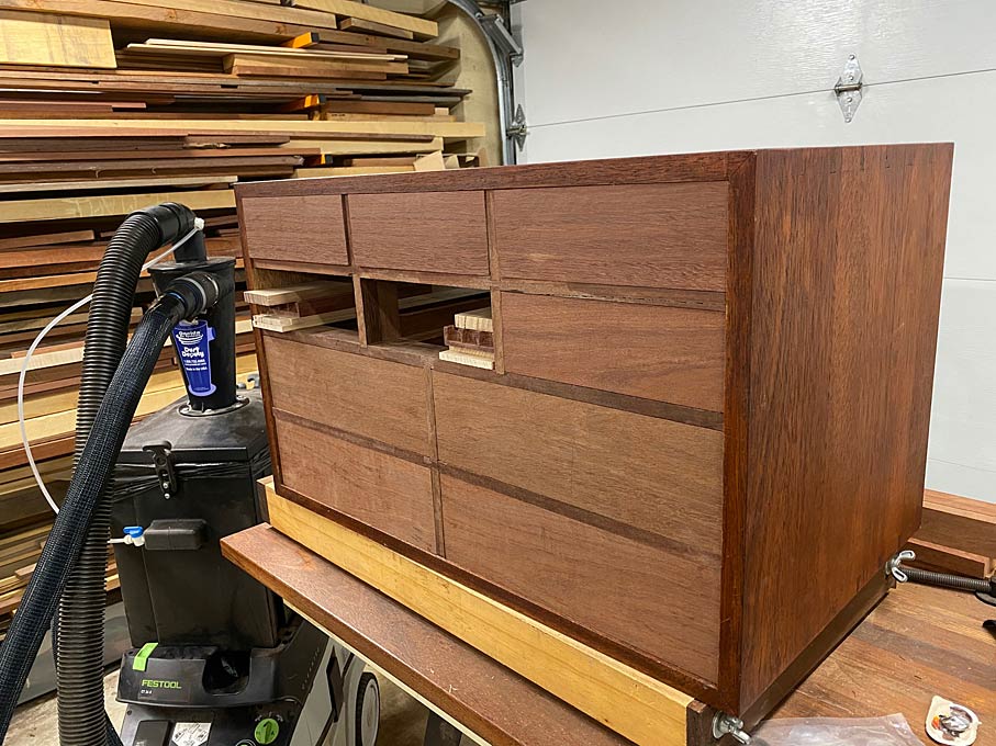

I recently wrote that I aim to build as best as I can. Sometimes it does not go well at all :(

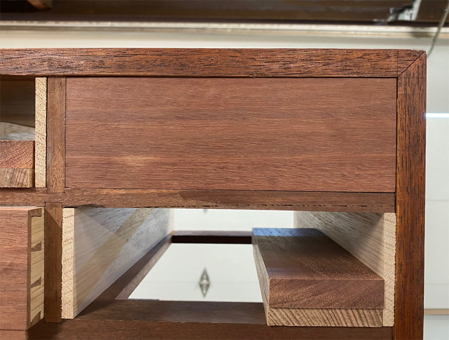

I make two repairs today. Usually, the mistakes I make are as I get spatially challenged, and cut the wrong side of the board. The first one here was being a little over-enthusiastic with a block plane when trimming a drawer front (a few days ago). The problem is difficult to detect from a distance ...
... but close up .... !

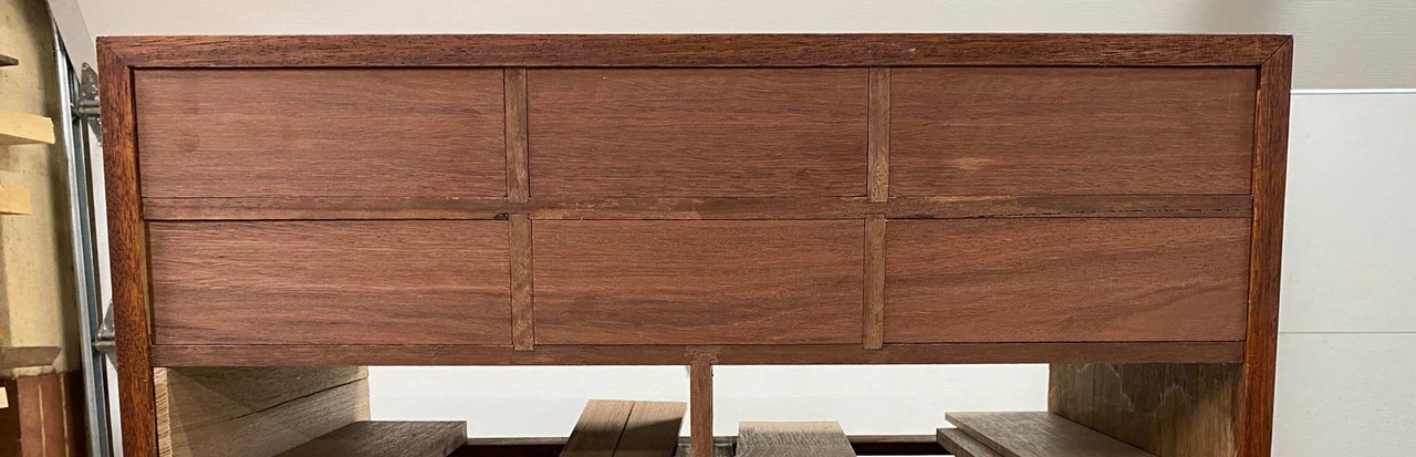

darn. The drawer front is part of a set of three. It cannot simply be replaced. One also cannot glue a filler to the side of the board.
But one can add a filler to the drawer divider ...
Here it is glued proud ...
When trimmed flush, it is nearly invisible. With a coat of finish, it will be ...

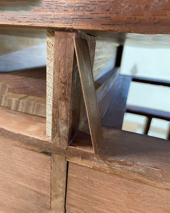

The second fix was this ... after all the mention I made about the importance of a combination square to ensure the side was square to the drawer front ... well, one got away from me. When I placed the three sides on a flat surface, the far end of one side was about 3mm high.
This was the fix. Can you spot the repair?
Eagle eyes will note that there is a light line. This is where a triangular fillet was glued in, and planed flush (The corresponding top side needed to be planed down to fit inside the drawer case).

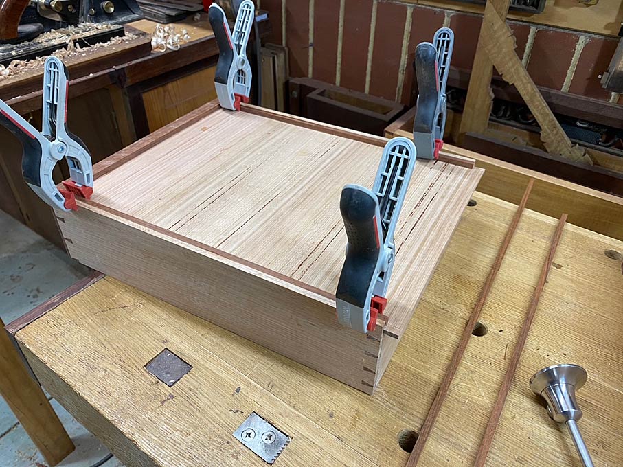

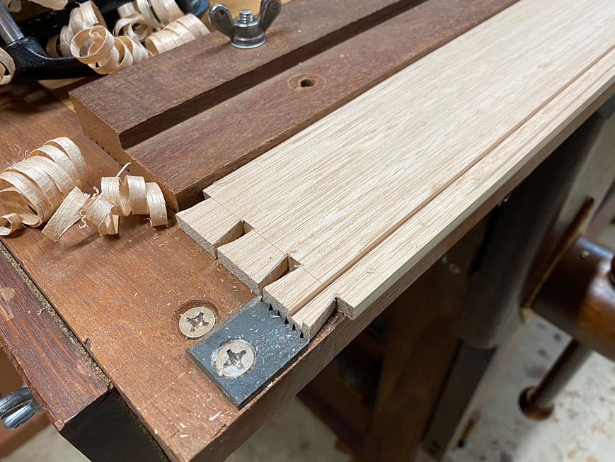

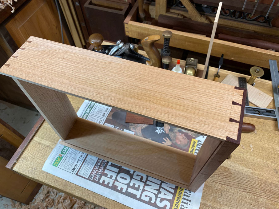

In the previous article, the focus was on strategies for connecting the drawer front and drawer sides via half-blind dovetails. The aim there - and continued here - is to complete the dovetailing in such as way that the drawer may be glued up, and dry inside the drawer case. The advantage of drying inside the drawer case is that a good fit is assured.
Today the drawer back needs to be attached with through dovetails.

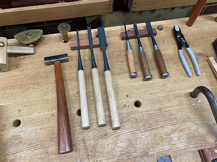

For interest, here are the chisels I used: Kiyohisa slicks and Koyamaichi dovetail.

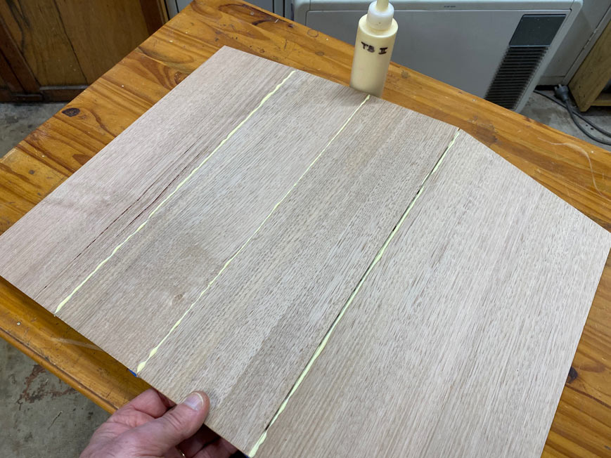

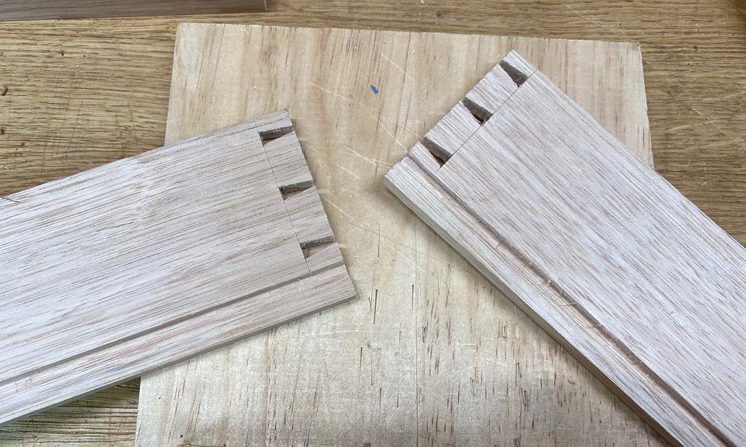

Noticeable in the drawer above is that there are no grooves for the drawer bottom. These will now be added using a plough plane and a sticking board to hold the work...
The drawer sides are around 7mm at this stage, with the expectation that they will end up at 6mm. The inside and outside faces have been planed. The groove is 3mm deep ...
The groove in the 18mm thick drawer front is 6mm deep ...
The drawer back receives a shallow groove ...

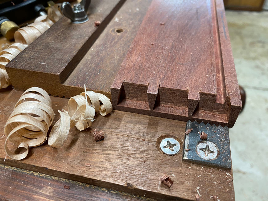

We move over to dovetailing the rear:

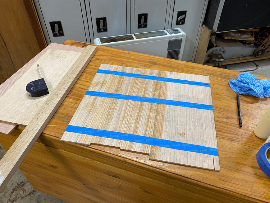

The first step, with 6 drawers of the same height and width, is to make a template for the spacing of the dovetails.
While the template stretches across the board, the area of importance is above the drawer bottom.

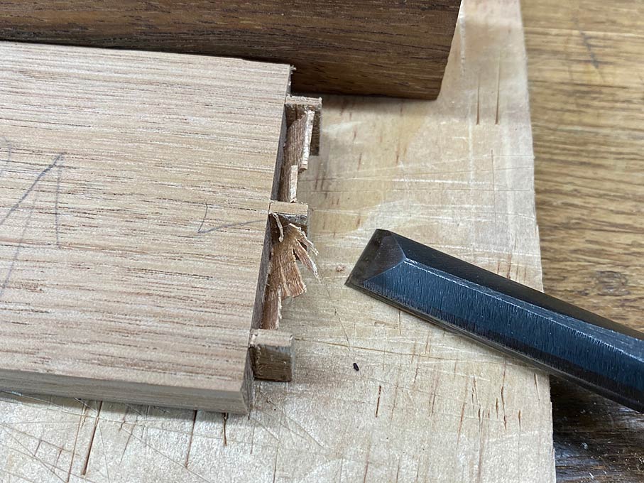

Mark out the tails, as usual, but then flip the board so that you are sawing from the inside of the drawer ...
Again, this is not a box. The inside of a drawer is seen, and it is important to keep the baseline as clean as possible, that is, no over-sawing.

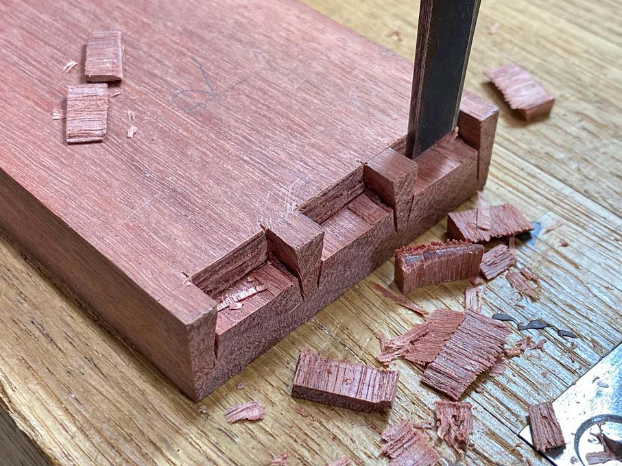

Similarly, when removing the waste with a chisel, start with the outside face of the drawer, and finish with the inside. That way there is less danger of inadvertently chiseling over the baseline.

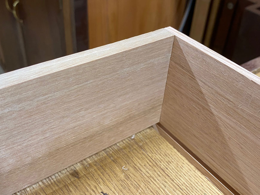

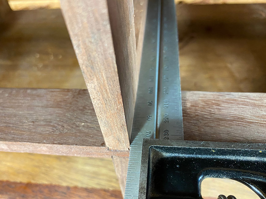

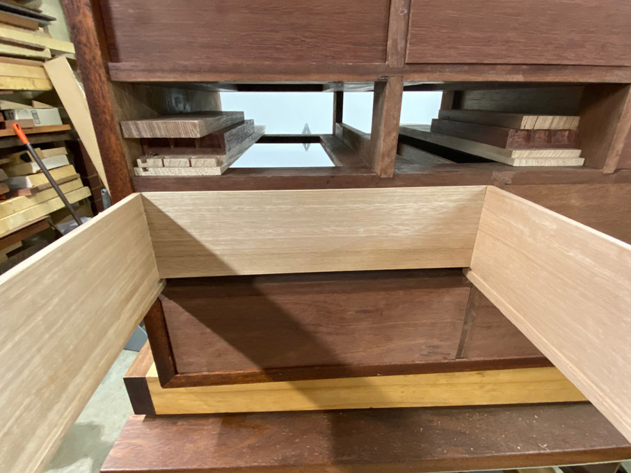

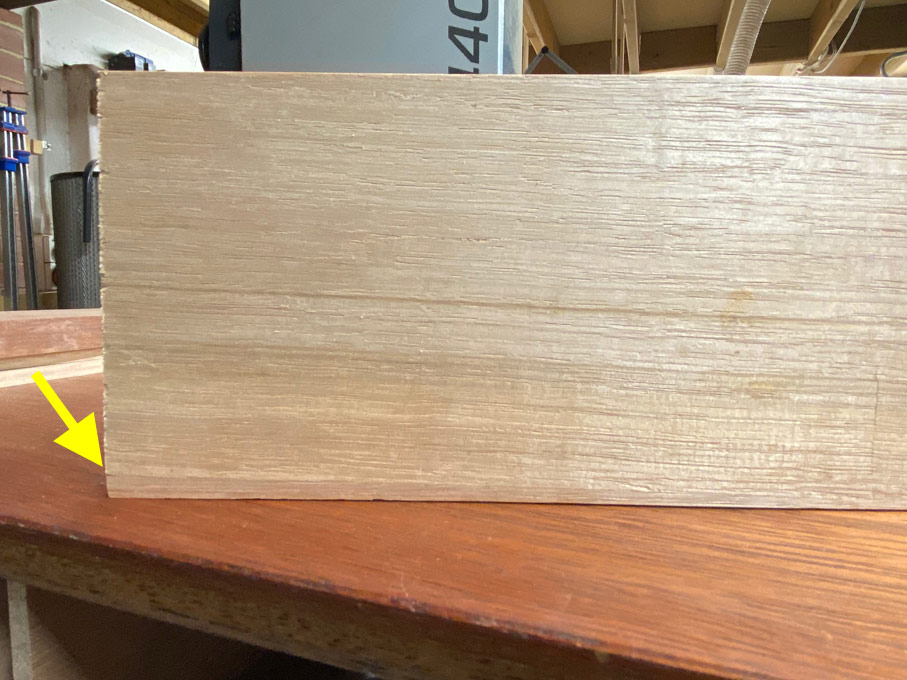

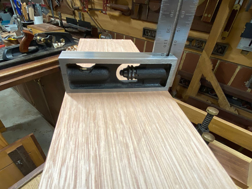

Now ... the interesting part comes with transferring tails to pins. This can make-or-break the drawer.
Here we see the tail and pin boards aligned. But are they?
A square shows that the side is out at least 1-2mm at 300mm (12").
Left like this, the drawer will not sit flat. It will act as if it has a twist. Significant efforts will need to be made to align the drawer in the case. It becomes essential that the side is aligned accurately. This can be a little fiddly, but a long square helps considerably ...
At some point, someone will mention the side-alignment fixture designed by David Barron. This is a wonderful concept, however it excels at making boxes and not drawers. Look here ...
The tail and pin boards are not aligned at the square ends (which would enable David's fixture to be used). They are aligned on the reference side, which is the lower edge of the drawer sides. You are aligning from the left side of these boards ...
Having transferred and sawn the tails, the bulk of the waste is removed with a fretsaw (as detailed before). Here is a reminder - first chop out the waste from the outside face, half way down ...
... and then complete from the show-inside face.
My preference is to angle the chisel slightly away and create a "tent" ...
This is then removed with a slicing paring action, again form each side to the centre ...
Use a narrow chisel to pare the ends: having first sawn these away, the remnants for paring lie above the chisel walls (again discussed in a previous article) ..
This is what we are after: flat ...
Dry fit ...
The drawer must fit the drawer case ...
It does, but we are not finished. More in a while ..
The aim is to glue up the assembled drawer and let it dry in the drawer case.
This drawer fits ...
... however it is a tight squeeze and I know that there are issues which need to be corrected before glue is applied. It is the same for every drawer.
Each drawer needs to go through an assessment, trouble-shooting for issues, until the drawer moves smoothly.
I need to point out at this stage that, although drawers are made in batches (a row), each drawer is fitted, tuned, and glued up before assembling the next drawer. At this stage, six (of ten) drawers have been completed to this stage. There is one further stage after this chapter.
So we pull the drawer out of the case. It comes out with effort. The sides twist slightly - I can feel one side is moving more freely than the other. Something is causing it to hang up.
Examining the half-blind dovetails, the first item of note is that there is a slightly raised pin ...
Since the drawer is a dry fit, it is a simple matter to knock it apart to make any fixes.
The pin is planed flat.
I note that the one drawer side sits a little proud at the underside, about 1mm ... maybe not even that much ..
This is also planed down.
The drawer back is presented to the case opening ...
It is a tight fit now. It will be a tighter fit later if there is moisture in the air. The drawer back is removed and the height planed down by about 1mm. Re-assembled,
the sides now are higher ...
The sides are planed to the side height ...
I can still feel a little more stickiness on one side. Are the sides flat, or has there a cup developed to create a high spot?
Yes. Slight but it is there ...
Plane this flat. Just a few thin shavings ...
Now the drawer is moving well - it feels taut, but free.
The case is waxed, not so much at this stage to promote ease of movement, but to prevent any glue adhering to the sides ..
Now we are ready to glue the drawer parts. Here are the items involved ...
I am using Titebond Liquid Hide Glue. I like that it has a longer open time, that it is reversible, repairable, and cleans up with water. There is a spatula for application, a fishtail chisel handy if a corner needs to be cleaned, a small mallet, and a wet rag.
The hide glue is decanted into a small bottle ...
This small bottle is a game changer! I was watching Rob Cosman and noted that he used small bottles as well. I found a bunch on eBay. What they do is let you deposit glue in exactly the spot you want to do, and then the spatula lets you spread it around.
I only glue one side of the joint, but there is enough for both sides ...
It is important that the sides are seated flush ...
The drawer looks good ...
... and, importantly, slides into the case smoothly and firmly.

Before starting on the bottoms, the drawer fronts are planed, chipped dovetails repaired, and fine-tuning of the bottom-less drawer is completed ...
Link to the fixture here: http://www.inthewoodshop.com/ShopMadeTools/DrawerPlaningFixture.html

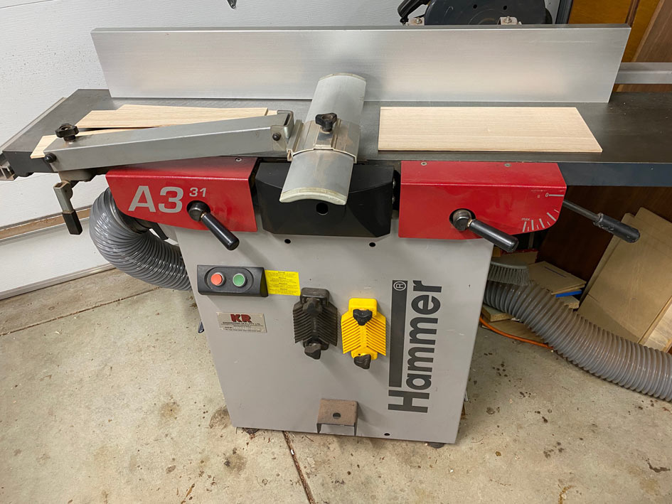

Modern machines, such as jointers and thicknesser/planers, enable the redesign of cabinet parts. In this case, drawer bottoms. One can use the minimum thickness, saving weight and wood.
I am very fortunate to own a Hammer A3-31, which turns the scrap into usable boards ...

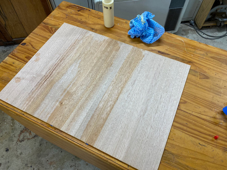

These boards ended up a smidgeon over 5mm thick. The grooves in the drawer sides are 5mm wide and 3mm deep. The drawer sides are 6-7mm thick.

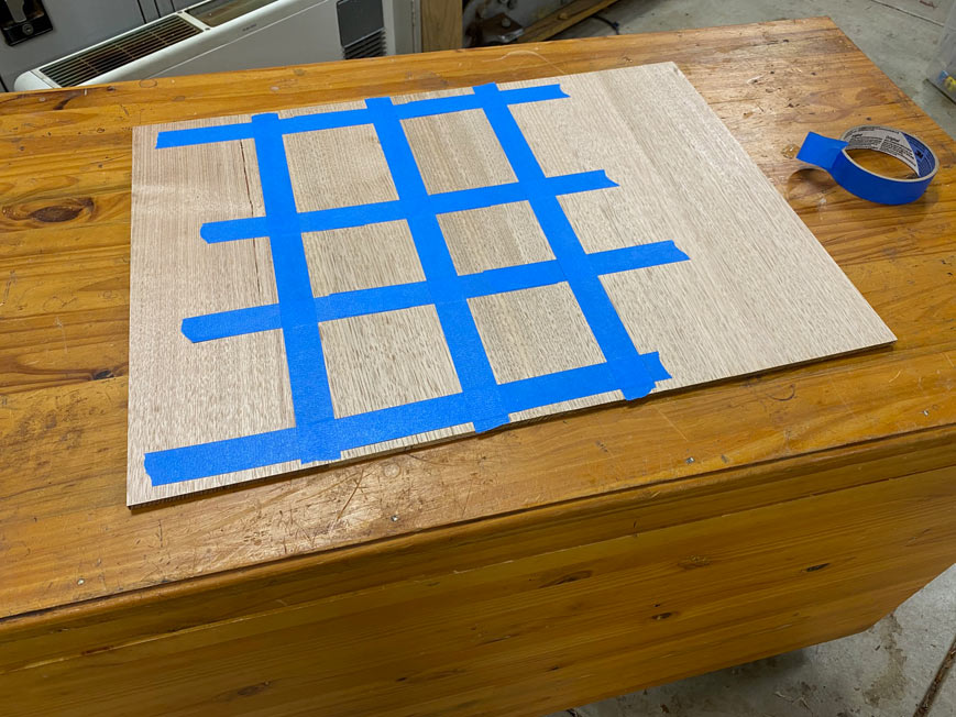

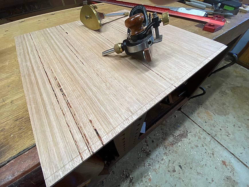

Joining such thin boards is quite easy - no clamps used. Just blue tape :)
Butt two boards, and stretch the tape across the join. The blue tape has some flex to it, and the stretch contracts and pulls the joint tight ...
Do this with all the joins, and then lay a strip down the seam (which is to prevent glue squeezing out ...
Flip the boards and insert glue into the seam. Wiggle the boards open-and-closed to spread it evenly.
Lay flat and wipe away the glue (Titebond II) squeeze out with a wet rag. Freshen this for each join.
Yes, I know many warn against this practice, but I have not experienced any problem with finishes. Once clean, tape the side to hold the joins tightly together ...
The machining and glueing takes all day, and finally ...
Of course - Murphy's Law - the next day I discover that I am going to be one drawer short, and more offcuts are found and glued together. Smaller pieces this time ...
Then it is time to unwrap the presents and make a blue tape Christmas tree ...

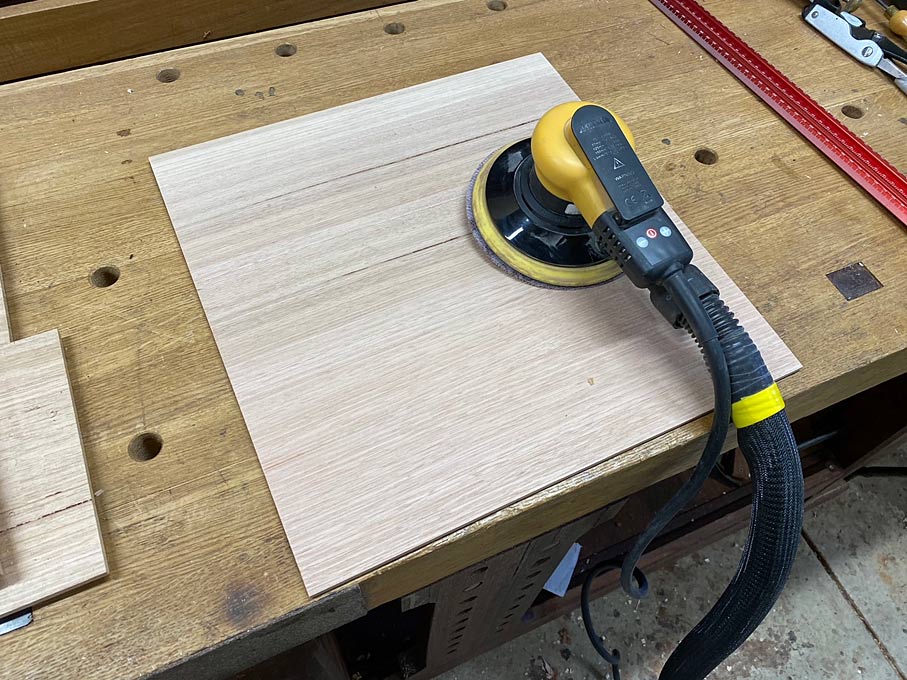

The drawer bottoms are roughly sized, and the top side is sanded to 240 grit (the underside will not be seen, so just leave it be) ...
Why sand? Well, it is just easier. The panels are curvy, not flat, and would be too awkward to hand plane. This is what sanders are for. What I have here is a Mirka Ceros, which uses Abranet mesh. Hooked up to a vacuum cleaner, the result is the closest thing to dustless sanding.
One edge on the underside receives a very shallow rebate. This is to enable the panel to fit the groove. The plane here is a Veritas skew block plane, which has a nicker as it is planing across the grain. It has a fence and a depth stop. Great little plane ..
The width of the panel is measured. Note that the drawer bottom runs across the drawer (expansion then takes place front-to-back) ...
After ripping to size on the table saw, fine tuning takes place with a shooting board ...
Time to fit the drawer bottom.
Of course, if it is too tight, it will not run smoothly. But even if it appears to run smoothly, it can be creating a potential problem.
In the earlier chapters (Dovetailing for Blood), one aim was to make the dovetails an exact depth so that the newly glued drawer could dry in the drawer case. The other aim was to fine tune the drawer (minus the drawer bottom) to move smoothly in the drawer case. Now, if when adding the drawer bottom, the smoothness is lost, then we know that something is wrong.
So, the drawer bottom is dropped part way ...
... and this is presented to the drawer case at this point. Will it run as smoothly as before?
If the drawer appears to have tightened in the case, the problem may be that the sides are slightly bowed. Try tapping the sides to push them flat ...
The drawer bottom is lowered further, and again tested for fit ...
All good, and the bottom is tapped into the groove behind the drawer front. A good fit :)
Slips are a traditional way of reinforcing thin drawer sides to increase the surface area and reduce wear over time to the runners. Usually when making slips, I would groove the slip rather than, as here, the drawer side.
Here is one of Richard Jones' wonderful illustrations ...
I decided to do something a little different this time. I am not sure whether this can be termed a true slip, but it functions exactly the same way. The drawer sides have a shallow 3mm groove. To support the thin drawer side, as well as support the drawer, a 6mm square Jarrah section was glued to the drawer side directly under the drawer bottom. Care was taken to allow the drawer bottom to remain free to move.
Drawer stops were added ...
All the drawers fit and move smoothly ...
And this is what it looks like at present ...
Of course, there is the case back to make, and the handles to fit .... and then the fun bit begins - fitting out each of the 10 drawers for tools. Lots to do still.
