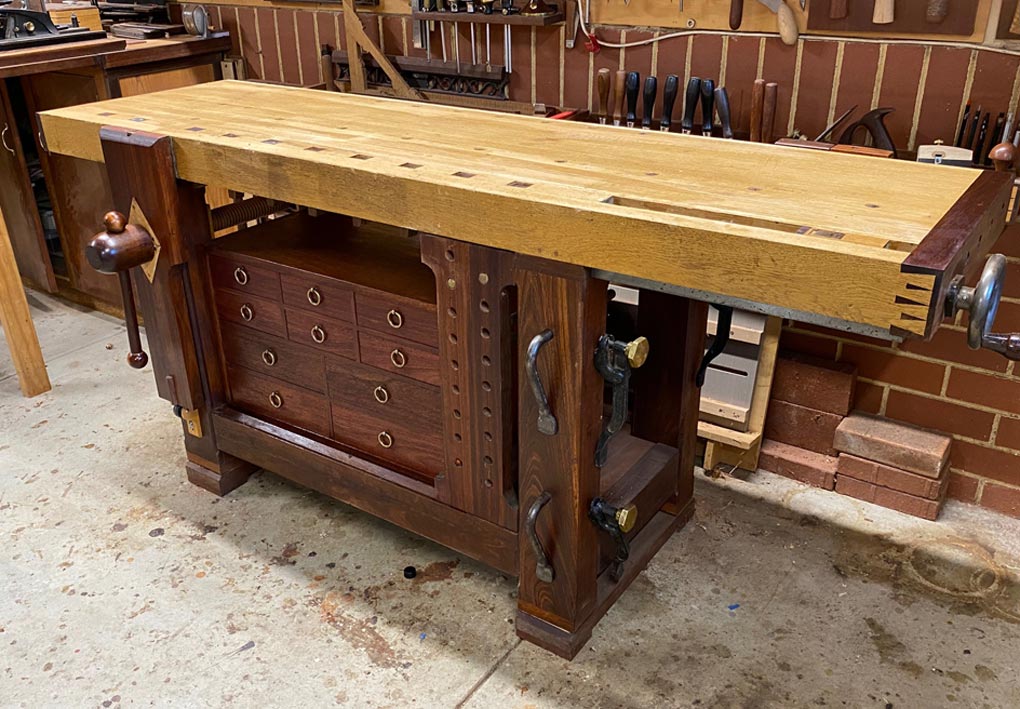

These are final pictures of Stage One. "Stage One" - what does that mean? Well, the first step is to build the cabinet under the bench. The second stage will be to fit out the drawers for the tools. I plan to do some of the latter shortly, and some later. I will post these as they are done. For now, here is the underbench cabinet ...
The rear, before the back was installed ...
The front. The ring pulls are antiqued brass (they are not shiny). I need to work them a little more to remove the still-new look. These were chosen as they drop down and do not project out from the front of the cabinet  ...

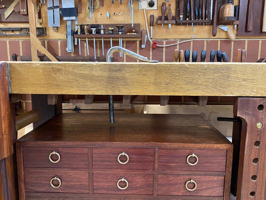

Under the bench ...
The bench top received a little flattening, and a single coat of danish oil ...
Someone is sure to ask why the cabinet is low. The answer is that there needs to be space for hold downs ...

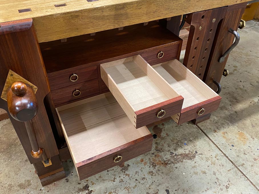

The drawers manage about 90% extension ...

What lies behind drawer #1?

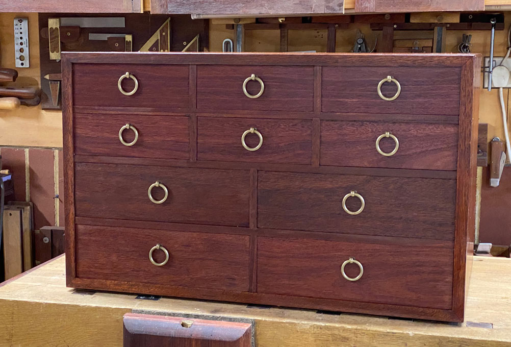

The underbench cabinet is done ....
... and now the drawers are being filled, starting with the centre drawer in the top row.
There are 10 drawers in all, and the aim is to use the space as efficiently as possible. Into this cabinet will be those tools I want close at hand, and to access readily.

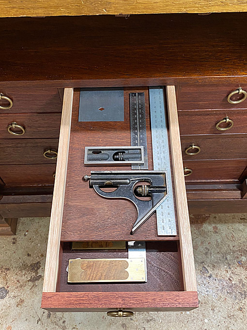

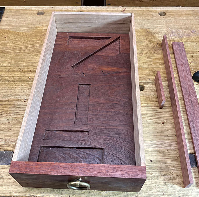

The centre drawers in the top two rows are for marking tools. The top drawer will be for squares I use all the time.

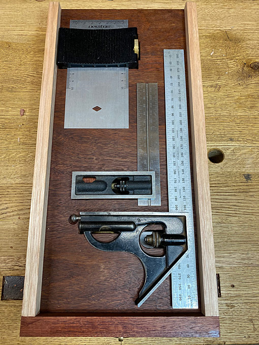

Opening the drawer produces a 300mm Starrett combination square, a 150mm Starrett double square, and a Veritas Sliding Square. these are french fitted into a Jarrah panel (more on the french fitting shortly). ...

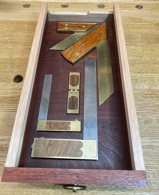

Now you know how I like secret drawers :)  - well, if you slide this panel back ...
... you find the treasure drawer with a pair of Colen Clenton mitre squares infilled in Sheoak, and pair of Chris Vesper 4" and 7" squares infilled in Tasmanian Blackwood, and a 2x2" Bridge City saddle square ...
The Jarrah panel for the latter squares is a loose fit, snug at the sides and about 5mm of expansion space at the end. At the right side of the photo are the rails, which were glued to the sides (but not the loose panel)

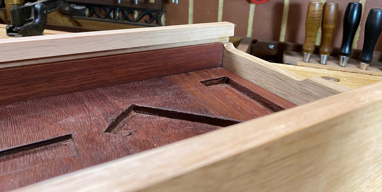

Below is the upper panel for the Starretts and Veritas squares. The panel needed to be thin - it is 6mm thick - and cut outs made rather than french fitted. This was to save space by having the tools handing down rather than sticking up.
The eagle eyed will have noticed that the rear of the drawer was cut away. This was to allow for the upper tray to slide past the drawer back, which takes advantage of the space behind the drawer when it is opened.
There was a little extra shaping as the body of the Veritas hung down lower than the other squares.
The upper tray runs on the Jarrah rails attached to the inside of the drawer sides. Finally, there is a rail added above the tray to prevent it tipping as it is slid back. This is in the same Tasmanian Oak as the drawer sides.
The drawer manages about 90% extension without any support.

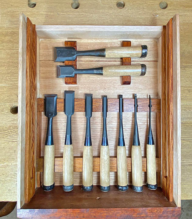

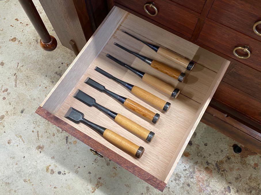

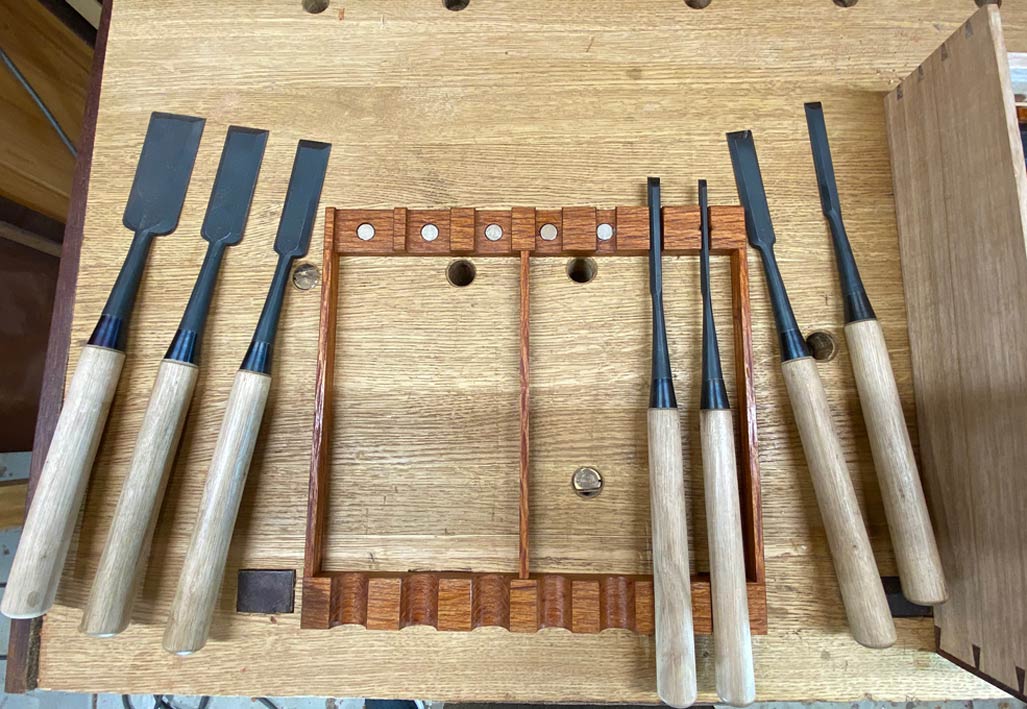

The drawer holds my Kiyohisa chisels: paring slicks and bench oire nomi. It is important to be able to find, and extract them easily when working at the bench.

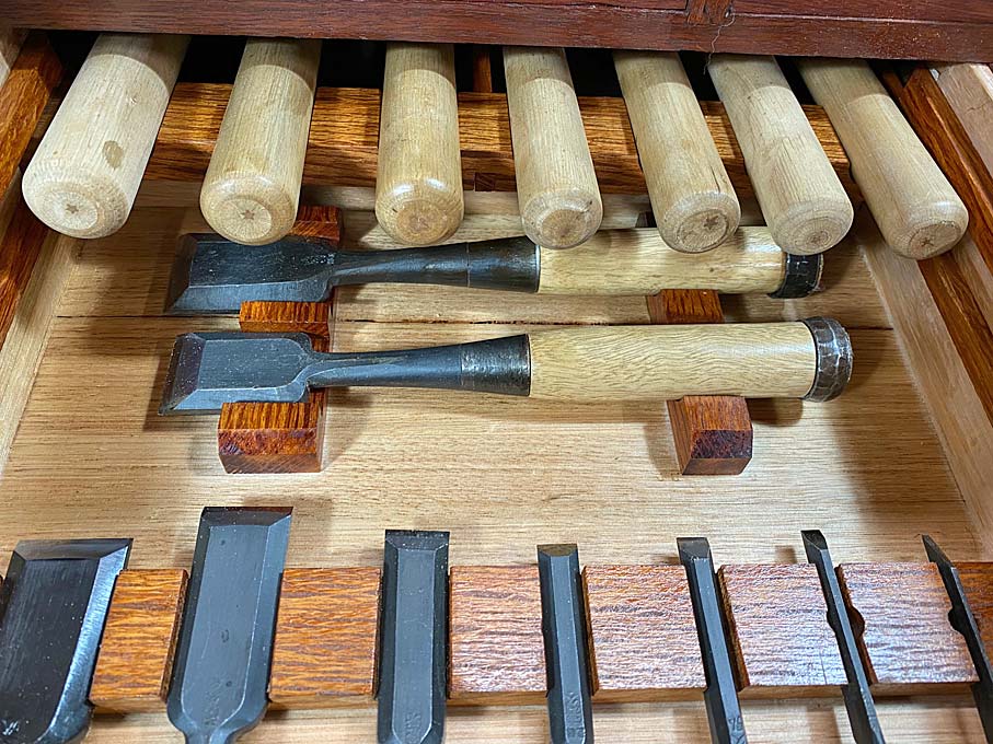

The paring chisels lie in the upper level ...
These slide into the cabinet and, below, are the oire nomi (3mm through 30mm) ...
There are two others at the rear, a second 30mm and a 36mm ...
This is a clearer presentation ...
The chisels lie on shaped rests. The blades lie on rare earth magnets, which prevent them moving from the rests when the drawer is opened and shut, or the top layer extended into the cabinet ...
The wood used for the rests and the slide is West Australian Sheoak ...

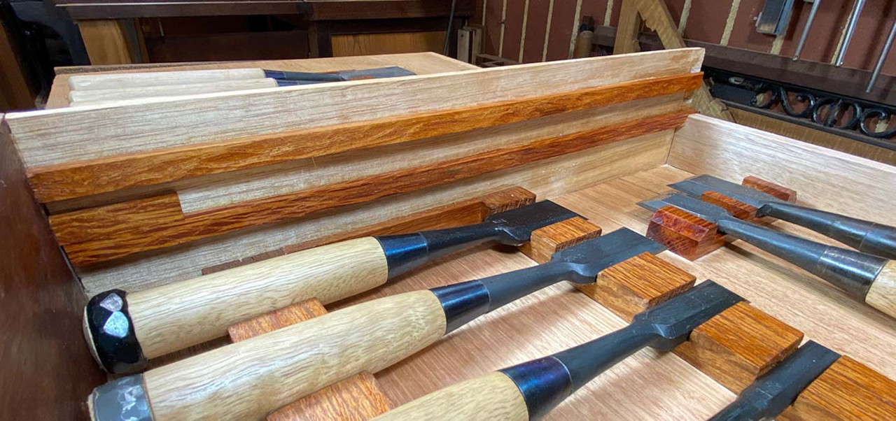

The rear of the drawer, the drawer back, has been cut away above the second dovetail. This is how the the top layer slides into the cabinet ...
