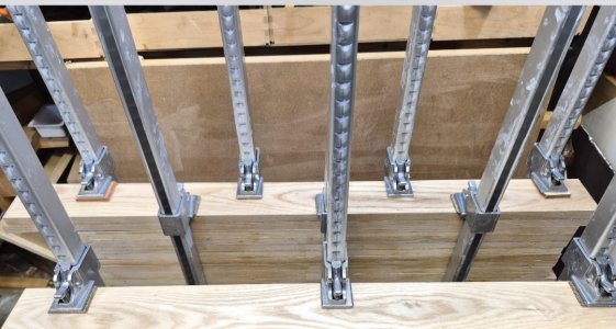

My go-to clamps are now the Dubuque. If I started fresh again, I would just buy once, cry once and get everything Dubuque in place of the Bessey K Body or similar clamps.

I know these clamps get a lot of praise. They get a lot of compliments from one of the YouTube channels I respect, and because of that I bought a pair.
But honestly, I find them awkward to use when gluing up cabinet parts, like panels, rails, and stiles to make up the sides. I muchly prefer K body clamps, and have a number of the Bessy Junior Ks (I think that is what they are called). I also use DeWalt trigger clamps of different sizes.
The main issue with the Dubuques, as I recall, is being able to stand the assemblies up and otherwise position them in different ways when doing glue ups. I honestly don't remember the details since it has been a year since I tried to use them. I just find the K body clamps easier to position, manipulate, move around, etc.
